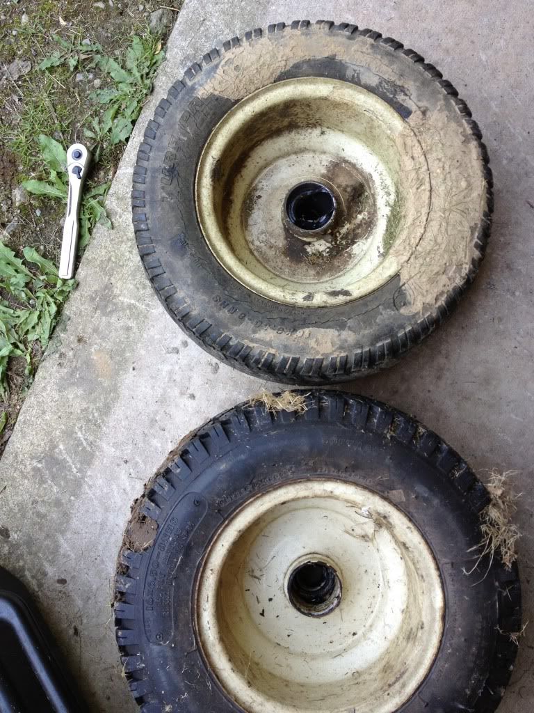

Hey gang! I'm attempting to swap out the front wheels on the running 1641 for the ones on the parked 1210 since the tires have so much more meat on them. I brought over a 1210 when and had to punch out the inner bearing and I notice it doesn't have a grease fitting in the inside of the wheel like the 1641 wheels. Also, there's no grease on the inside of the 1210 wheel while the 1641 is loaded. What should I do? Swap anyway? Or do the 1641 wheels need to stay with the 1641?

the wheels should be the same both are 1in just the newer ones have the grease zerks

The wheels definitely appear identical. I'm wondering if its worth it to just swap them or should I wait until I get a chance to bring them to a tire shop and just swap the tires...

Pack the wheel bearings for the 1210 and slap them on the 1641, let the good times roll.
Thanks Sam. You Da Man, as always.
I figured I could get away with it. Just wanted someone who knew what they were doing to back me!

If you want to get fancy I can show you how I set up my 1210 so it could be greased with a grease gun.
