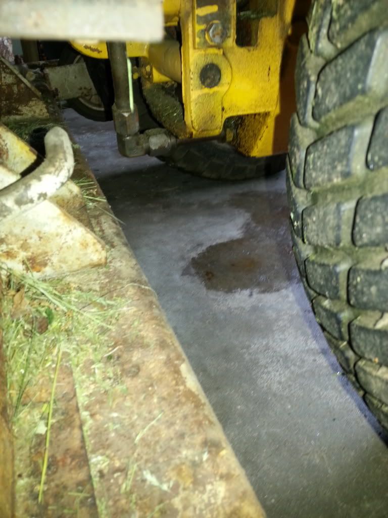

Hey all, I recently noticed I've got two solid leaks coming from my new to me 105. One looks to be the right rear wheel axle carrier gasket:

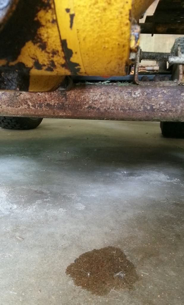

The other developed after my first mowing session at the center of the tractor. Based on other threads, I thought it might be that cork gasket that everyone says seems to be typical but upon taking photos and looking at parts diagrams I'm a bit nervous that I have some non standard plumbing for my "cooling tube" and that might be the source of the leak.

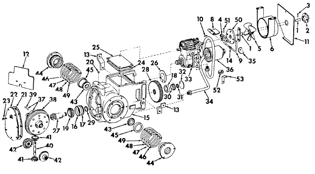

That doesn't look at all like #34 on this drawing:

I am goin threw the same issue with a leak on my 149. I ran into that pipe problem on mine. There was a year break and a design change to that pipe. A one piece like I have and a three piece like you have. Both fit and both serve the same purpose. I thought my pipe was leaking but when I replaced the crush sleeve it is still leaking from the hydro. Seems to be the cork gasket. Hope this helps good luck.

Do not fret! IH used a dozen different pick-up tubes on the hydro rear end/pumps, and the one you posted is one of them.
About the only options you have is to clean the transmission and rear end well, wait for the leaks to reappear and then take the appropriate steps to correct them or tear it down, seal it all up and then wait for the leaks to reappear (this may take several years).
If you do pull it out to repair any leaks, you might as well reseal everything while you have it out... If that is the case, why worry about where the leaks are coming from you're going to reseal them anyway. Unless of course it is coming from the tube and then you would want to replace it.
