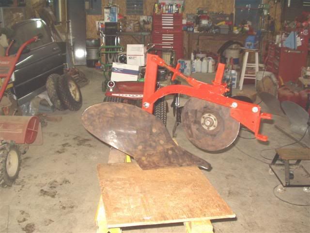

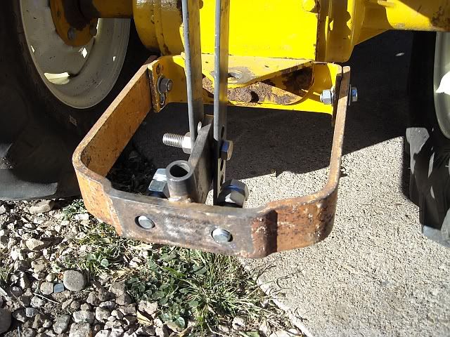

As for what size of plow do we recommend. Well that's totally up to you. But I will tell you this. I use a 10 inch Simplicity Plow and it works great. As for the type of Hitch you should use. Depending what type of hitch your plow has since these plows come in a 3 point hookup and a Sleeve Hitch hookup. But normally everyone uses a Sleeve Hitch hookup. If yours has a Sleeve Hitch hookup, you will need the Sleeve Hitch Adapter in order to hook up your plow. I'll put some pics at the bottom of this post to show you what I'm talking about. Well I hope this helps in one way or another??? Take care good buddy!!!!
MATT
Simplicity 10 inch Moldboard Plow (Thanks for the pic Dale!!!)

Jeff, you can get that brand new Sleeve Hitch Adapter at Carter & Gruenewald for $125.00 plus $8.00 for shipping. Just thought I would let you know. As for the plow, keep an eye on the ad section here on the forum. Sometimes, a member or two will have a plow for sale for a decent price and also ship it to you. Or you can go to our Parts Sources Section here on the forum. We have a good selection of parts guys that have a decent selection of plows for sale at a good price. If not, shoot me an email. I might be able to find you a good plow that's ready to go to work. Hope this helps in one way or another???? Take care good buddy. HAVE YOURSELF A GREAT DAY!!!!

All this time we're talking about a "sleeve hitch adapter". I don't think I have a sleeve hitch to put the adapter on. Do I sound completely ignorant?

You can plow with either a hydraulic lift or manual lift, doesn't really matter. Unless you have a spring assist on your manual lift, it will be much easier to lift the plow with hydraulics. Doesn't mean you can't do it with manual, just takes more effort. Here's a link for parts you'll need to plow. You'll need the plow, a 3pt hitch, and the sleeve hitch adapter.
http://www.onlycubcadets.net/forum/showthread.php?t=4
