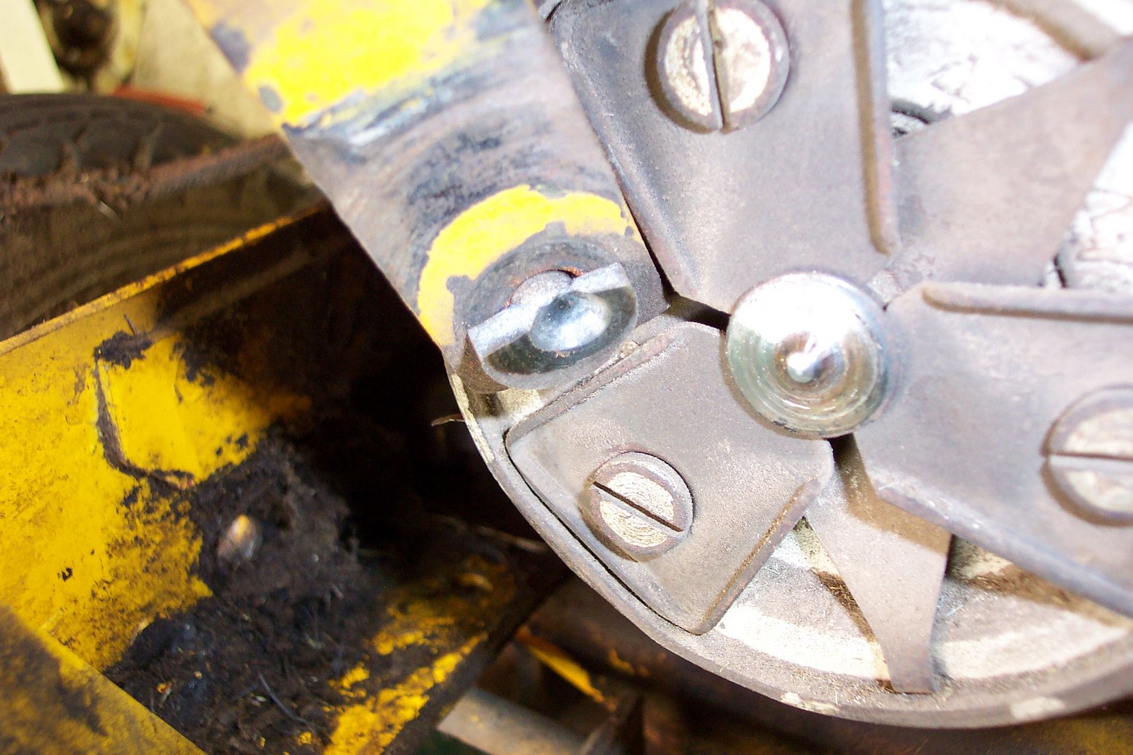

Here are pictures of my 100's PTO fiber button. It was installed on the last rejuvenation in 1995. I had to remove the button today to replace the PTO-to-mower belt. This mower has caught hell over the years since I use it to mow the lawn as well as a bush hog (and an occasional rock or two by mistake!).
I have bought several brass buttons, intending to replace the fiber button with a brass button when the fiber button wore out. I am re-thinking that move at this time. I am including a picture of the fiber button and a picture of the PTO wear button, which is holding up well. When I moved from NC to VA in 1999, the 100 was put in storage for about 5 or 6 years, then resurrected to mow the lawn ever since.
Today I replaced the belt and put the fiber button back into use! Mowed leaves today and tomorrow it will mow the yard!

Has anyone used a brass button for a long time? I realize that I have been lucky using this fiber button for 12 years, but I also worry about the effects of brass on the clutch button over time. If the wear button was made of oil-lite (sp?) then I would feel better about it.

I've had mine on for three seasons now. ( mowing every week plus snow duty ) Other than initial wear to match the curve of the center PTO button, it's been little to no wear.
Brass is much softer than steel so that will wear first.
I'll check to see if I can get a price on oil lite material for buttons.
