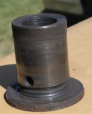

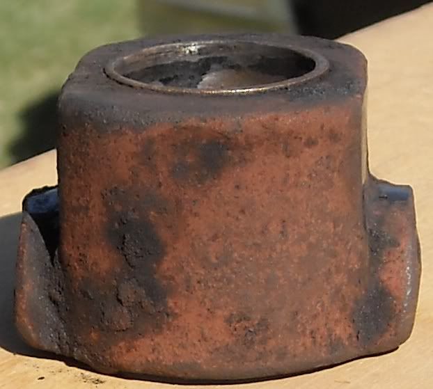

gcbailey, are these the two parts that you are asking about??? If so, both of these parts should move back and forth together as you press and depress the Clutch/Brake Pedal, even if the tractor is not on or in gear.
CLUTCH RELEASE COLLAR
CLUTCH SHAFT BUSHING

They move back and foward together when I have the engine turned on and the drive shaft is spinning. If I don't have the tractor engine on they just move back with the pedal once, you have to take your hand and move them back forward. Like a one way street.
