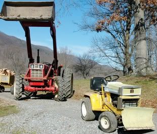

Take the cover off that is between the seat and steering wheel.
Just 4 little screws or bolts and it comes right off.
Look around inside, touch the parts.
Notice how you can get to stuff that might need serviced some day.
Now imagine if that cover were welded on instead of bolted!!
The NFs' and that 104 have that cover welded in place.
That is the reason I like the WFs' and QLs'
Theres a 584 sneaking into the posts again.....lol
