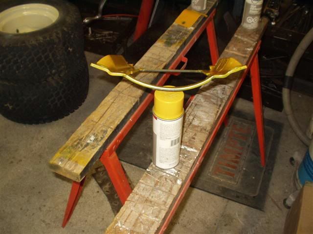

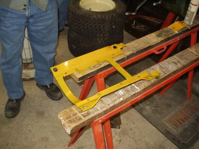

This is the modified cradle from my Dad's 1450:
Rear brace goes under the flywheel-blower housing:
Great pics!
