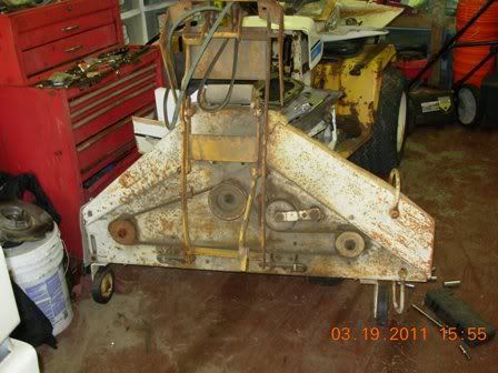

Helped a friend locate and purchase a 109 this week. Sweet tractor that has been parked for the last 10 years. A good coil and a little gas and it fired up. No pics of the tractor but he gave me this for a finders fee. He only wanted the tractor for gardening.

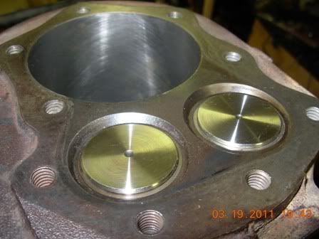

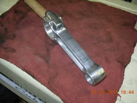

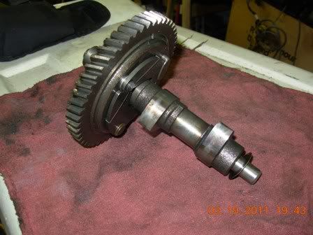

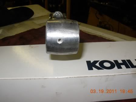

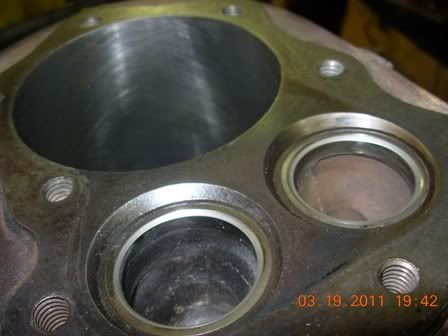

Also a few pics of the K321 pieces. Still need to port the block and blend the valve pockets.
Exhaust on the left and 30deg ground intake on the right.
New rod. Modified pin end with small oil passage.
Magnum 12 HP cam awaiting shipment to Ohio to be reground.
