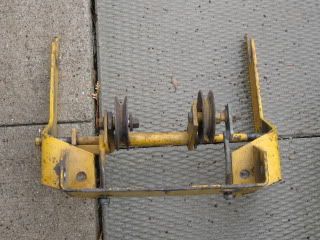

I read in other threads that the mule drive needs to be changed in order to run a tiller properly (ie belt tension). It was stated before that a mule drive that runs a "C" deck will not work due to the angle of the pullies as well as the fact that only one side has a bolt tensioner? Is this correct? Here is the mule drive that Wildbill used to operate his series 2 tiller on a 1450: tillermuledrive - wildbill.jpg
If I am understanding what was stated before....this style of mule drive can't be used? It seems to work fine for Wildbill's application?

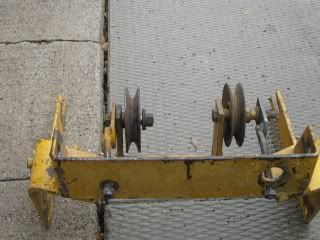

Here is what I have for a mule drive on my 982 which currently runs a 50C deck with no issues - but will it run a tiller? 982 stock mule drive.jpg
If I need to change my mule drive, does anyone have a picture of the one that I need to use? I have never seen one with two adjusting bolts on the pullies to adjust the tension on the drive belt going to the bearbox.

You need the mule drive with the straight pullys and the spring tensioner. you replace the spring with an adjuster bolt, I made mine with a piece of 1/8" steel 1x2" with a hole dilled in one end for the pully bolt to go thru and about a 4" piece of allthread welded to the other end to go out thru the hole where the spring attached, You'll need a fender washer there because the hole is big. And you have to have the solid pully at least on the left side, If not at least one of the new models that is welded all the way around. If you try to use one of the old spot welded pullys it will explode in pretty short order. I think I was very lucky not to destroy the $80 belt

It's not the pulleys themselves, it's the brackets they connect to on the mule drive. Take a look at yours and you'll notice they are bent slightly, as the belt for the deck doesn't go straight back, it goes off to one side.

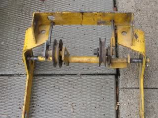

This is the mule drive that I use on my 1450 with my tiller.

Okay! Now I stand under!!
So the pullies on the mule drive that is pictured for use with a tiller.....what material are they made from? Cast, steel, ???
Since I am putting it onto a 982, what am I looking for .... a wide frame style mule drive? If so, is there a specific measurement I am looking for, or do I just go measure mine? Are they all the same, either wide or narrow frame - only the two widths?

I've never run a belt guide on mine. You can use any WF mule drive with 5/8" idler pulleys. I'm not sure that they made the billet steel pulleys for the 5/8" belts. I've never heard of/seen them. I think you can probably get away with the normal ones used for the mower deck as long as they are in good shape.
