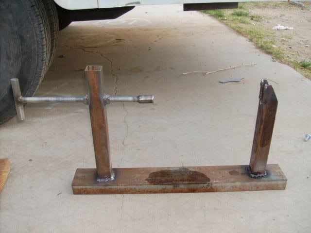

Al do you have it out of the tractor,Drive shaft and all??If so your gonna have to find yourself a spring compressor to compress the spring and then punch the roll pins out.Look in the tech section here on the fourm,there may be something in there.Merk has some pictures of his home made compressor,(spring),Ill check if I have a picture of mine and post it for you.Do you have a Manual,If you need one check in the tech section,there are some there but I dont know about the 70/100,I have one if you want me to Email it to you!!Others will be along to help also!!

Here it is very similar to them all !!!
