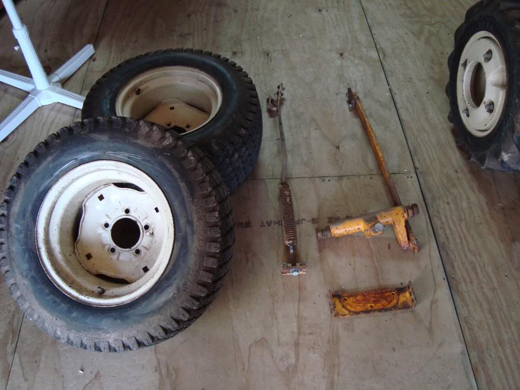

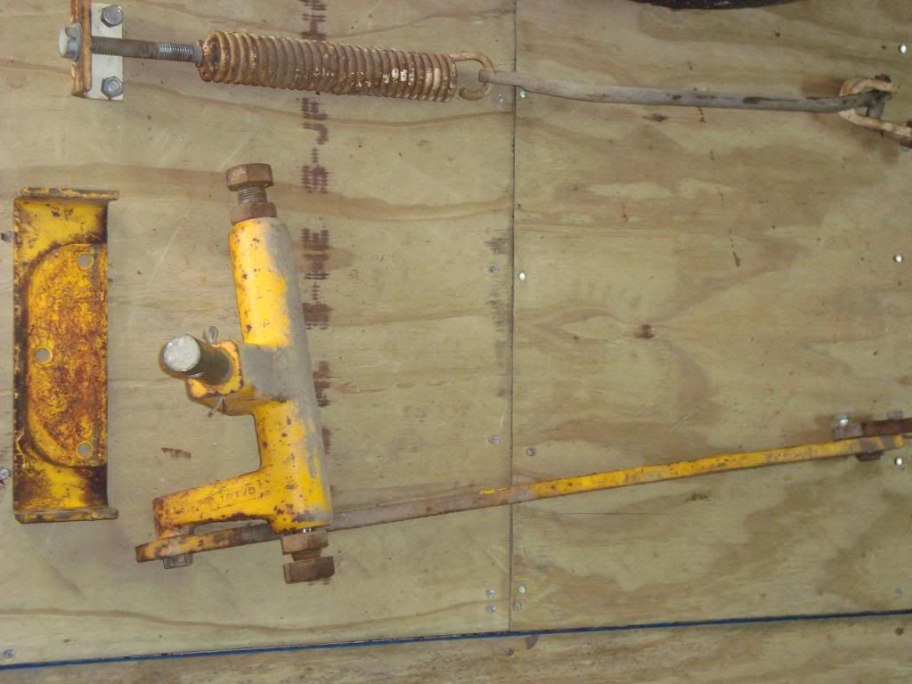

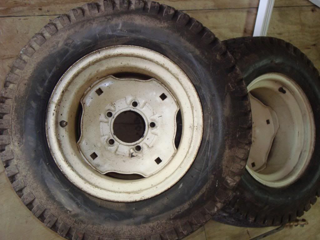

Went and picked up the lift attachment 3 point and the lift assist spring assembly. I also walked away with two excellent condition rear rims and 23x10.50 turf tires. The 3 point came off of a 1200 and had the (Frankenstein?) bolts to hold the lift casting onto the frame. It looks like I will have to buy the rod that the 128 uses to mount the lift casting. I considered knocking out the spacers but decided I didn't want to do that. Short of that I am also going to order the outer two point bracket to work with the inner two point I got with the setup. The Spring bolt works great for tension adjustment, not rusted and stuck like a lot seem to be. Now to save up for the Sleeve hitch adapter and linkage. Oh, not too bad for $50 and a little elbow grease.

You don't need to buy that rod...it's just a piece of cold-rolled steel with two holes drilled in it.
Old 07-05-2010, 07:09 PM
After I saw the pictures of it from one of the sponsors, I figured I would go across the road to the local machine shop and pick up a length of correct sized round stock and drill a couple of holes. Thanks for the heads up Matt.
