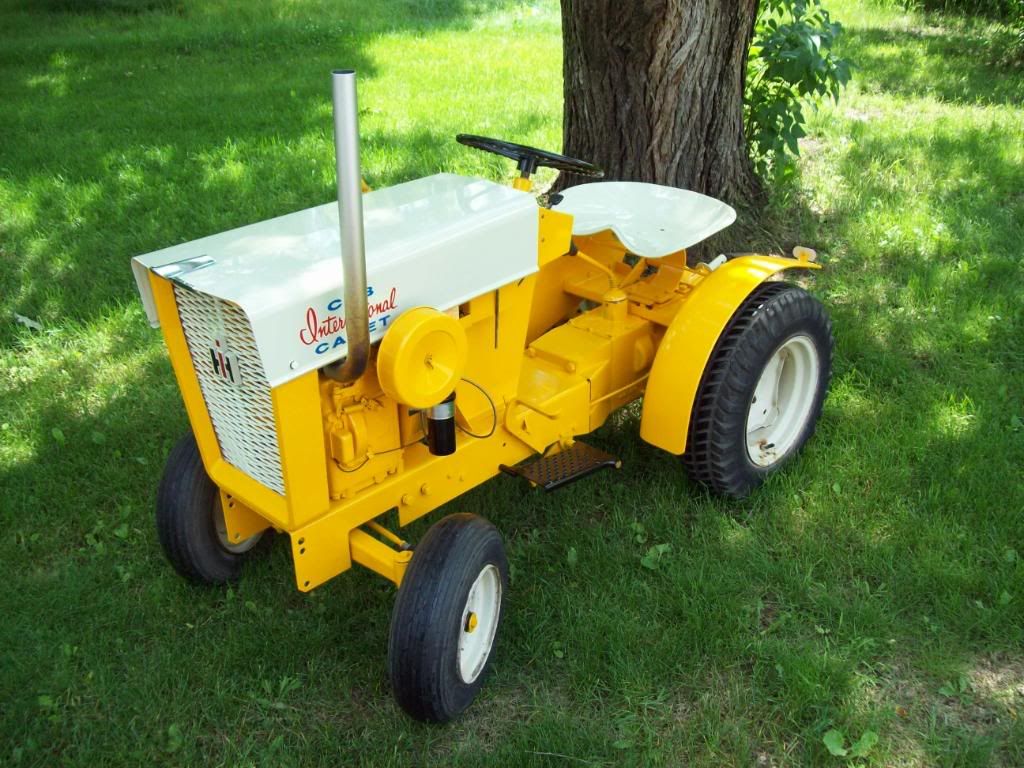

With a 1" EMT 90, and piece of 1/4 plate for a flange, a 8" baffle, a brazing torch, some rod, about $12 and an imagination you could build a really cool stack.
Here's mine.
I can't help you with the imagination, you're on your own.

This one cost me $5 at a local muffler shop, and took about 10 minutes for them to do...

Also the baffle and EMT is very light, I don't think you'll even need a brace. And they sound very nice.

Scott those straight pipes on that twin are cool.
Old 05-29-2010, 02:43 AM
VERY COOL Scott! How loud are they?

Those are pretty awesome Scott. I think Jay's suggestion is the way to go for me. A lot easier on my limited amount of free time. Thanks everyone.
