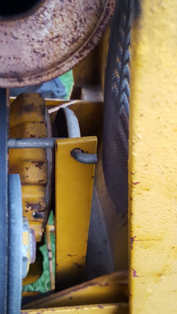

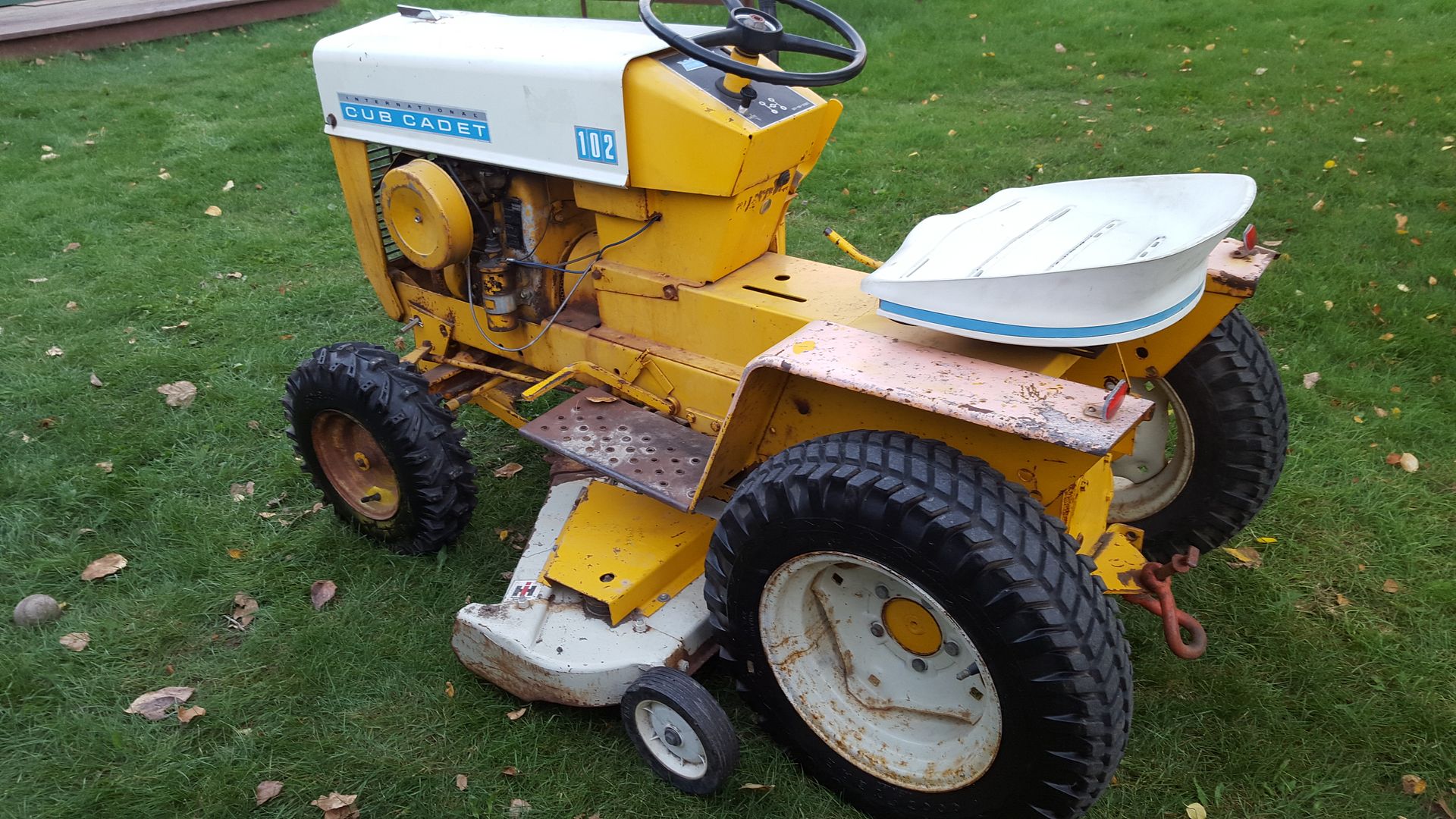

Hi all!! I'm new to the forum and new to Cub Cadets. I've always loved old tractors. I've been in need of a lawn mower, so when this beauty showed up at the auction yard I couldn't help myself. I got it plus a snow plow and a Brinley single disk plow. The mower seems to run great. The belt for the PTO to mower is not on the machine. I quickly looked at the pulleys for the mule drive and one seems locked up, so some new bearings are in the near future.
A question I have now is how in the world does the belt go from the PTO to the mule drive and onto the mower deck??

Very nice 102 with "oops" pedal! The rod that you have pictured that goes the Pto engage/release lever has a turnbuckle on it that runs up the right side of the engine. Loosen it enough to feed the belt in between it and the Pto then run he belt back to deck. Check with our sponsors above for your parts you need or place an ad in the wanted section. There's also free manuals in the tech section. Good luck and welcome!

Cool find. And that seat? Looks immaculate from here.

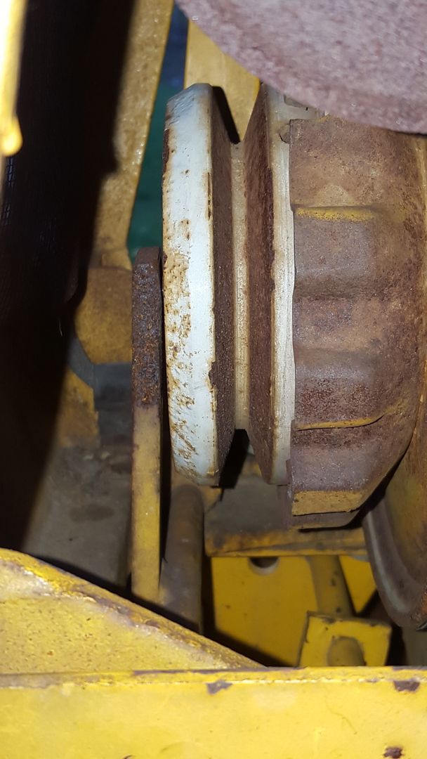

Posts: 4,503

That's a nice 102! Looks to be original. Hoods can be found at the sponsors on top of the page.

Can't tell if it's original but it even has the grill screen.
