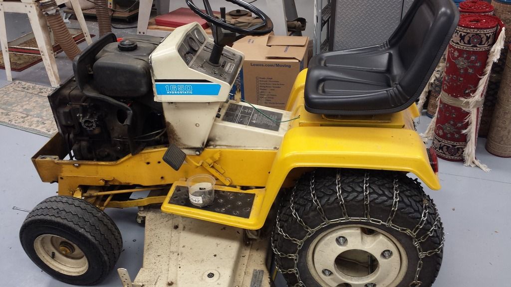

Anyway, the 1650 has been on grass killing duty at a third house we've been trying to sell for 4 years. I have only a small shed there, and go over there (11 miles away) and cut the grass every other week and keep an eye on the place. I'm hoping it will sell this year (now at 30% less than we paid for it in 2006) As I have limited tools there, I've had to deal with issues in a non-conventional manner.
After losing the PTO switch, I substituted the light switch to keep the mower working, then losing that I hot wired the PTO directly to the battery in order to finish one grass cutting session. I've also been dealing with it burning/losing oil at a furious clip, so I decided it was time to bring the ole' girl back to the shop and deal with the issues in proper fashion. The Trusty 108 (12hp) went over there to take up the slack.
I got the 1650 back to the new shop and began to take it apart. It was worse than I had realized, so it's a good thing it I took it out of service.

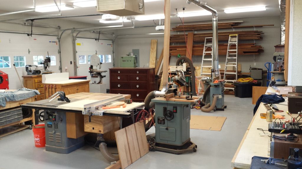

Here's the shop, so you can see why I've been so busy the past year.

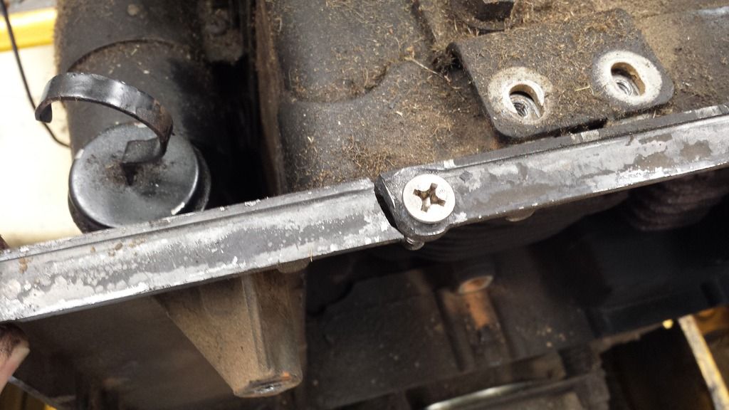

It was clear that the muffler housing was coming apart, and the aluminum portion had a good crack in it.

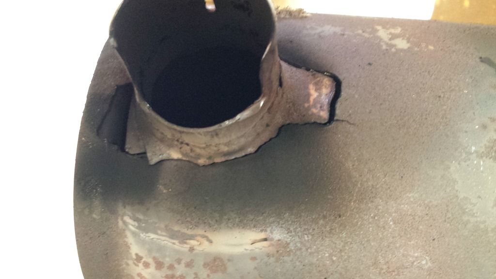

The muffler is shot. It cracked at the inlet.

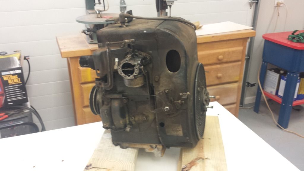

On the bench ready to be torn down.
The plan is a complete overhaul. With all the stuff going on these days, this is going to take a while. It will be two weeks before I get back to the engine.

Congratulations on your pending retirement and your first grandchild! Wow! What a shop! Very nice! I haven't ever seen a shop that clean! Lol wish mine was! Yeah I'd say she's due for an overhaul! My muffler was shot on my 1200, now has a straight pipe. Sounds very angry! Lol muffler box needed some tlc too. Have fun with your engine! Keep us posted. Good luck on your move! And welcome back!

Some progress. Got most of the engine disassembled but some of my tools are still at the other house, so I had to stop. I need to bring my flywheel puller, spring compressor, etc down here so I can finish this.
Here are some pics of the piston. Head gasket definitely was leaking-in fact the head bolts were all just snug, not tight at all. Haven't seen any other problems. Alum oil pan is fine, but will more than likely helicoil it as I've been doing with all the alum oil pans I find.
Piston is shot.
Did not see any markings on the piston other than this one notch. Is this a std size piston?

very nice !!! that shop is sweet!!! wow!! im a delta fan too...nice cub, good work...

What kind of fence is on your saw? Looks pretty cool, I just replaced
mine with a Biesemeyer. Sorry don't mean to derail

Unifence. It's a vintage 3hp Rockwell Unisaw.
