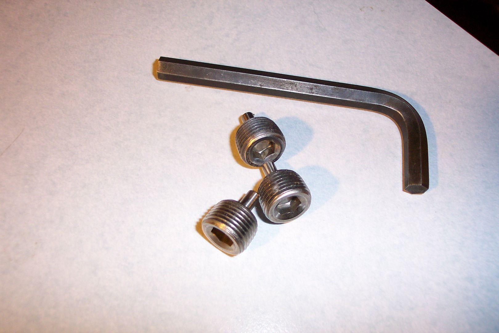

You may be able to tap it deeper if you use a hex drive set screw as your plug.
As a general rule, NPT taps are the correct depth when they are 2/3's of the way up the tap. ( obviously a gage is better but that will get you close ). A set screw style plug will allow you to sink it deeper.
I use these in my Cubs
click for bigger pic
