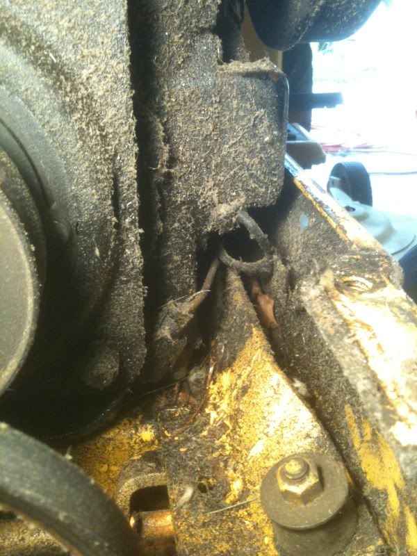

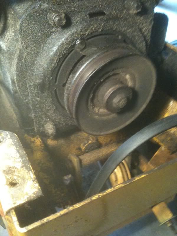

I've got a used 1450 that runs and cuts fine, but has a heavy oil leak. I bought it a week ago and have cut with it a total of about 2 hours. On the 2nd 1 hour session I noticed smoke in the engine compartment - it was the oil cooking off. Everything from about carb height down - and about forward of that point has some degree of oil on it - but it is worse on the carb side. The PTO pulley does not have a drop on it and the belt appears to be running clean also.
Thanks for any input.

Pull the PTO off and look at the shaft seal behind it....!!!

breather filter could be pluged and pushing oil out any plase it san also, jut a tht
