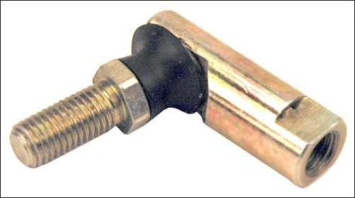

I was on my mower getting some leaves mulched up and my steering ball joint fell apart on my front left side. Anyway, I assume if I order part #723-0156 (from the parts manual I have) then that's all I need right? Basically the joint just came apart so nothing else is wrong with the steering components. Just wanted to make sure its kind of a plug 'n play part before I order it.

That should do it but I would also check the other joints to make sure they aren't ready to give up the ghost too.

Ark, I had the same thing happen some months ago with my SLT-1554 and replacing my ball joints was all it took to get me up and going again. It is good advice though to check all the other steering connections for excessive wear while you are at it. When I repaired mine I did order two ball joints and replaced both sides while I was at it. Good luck.
