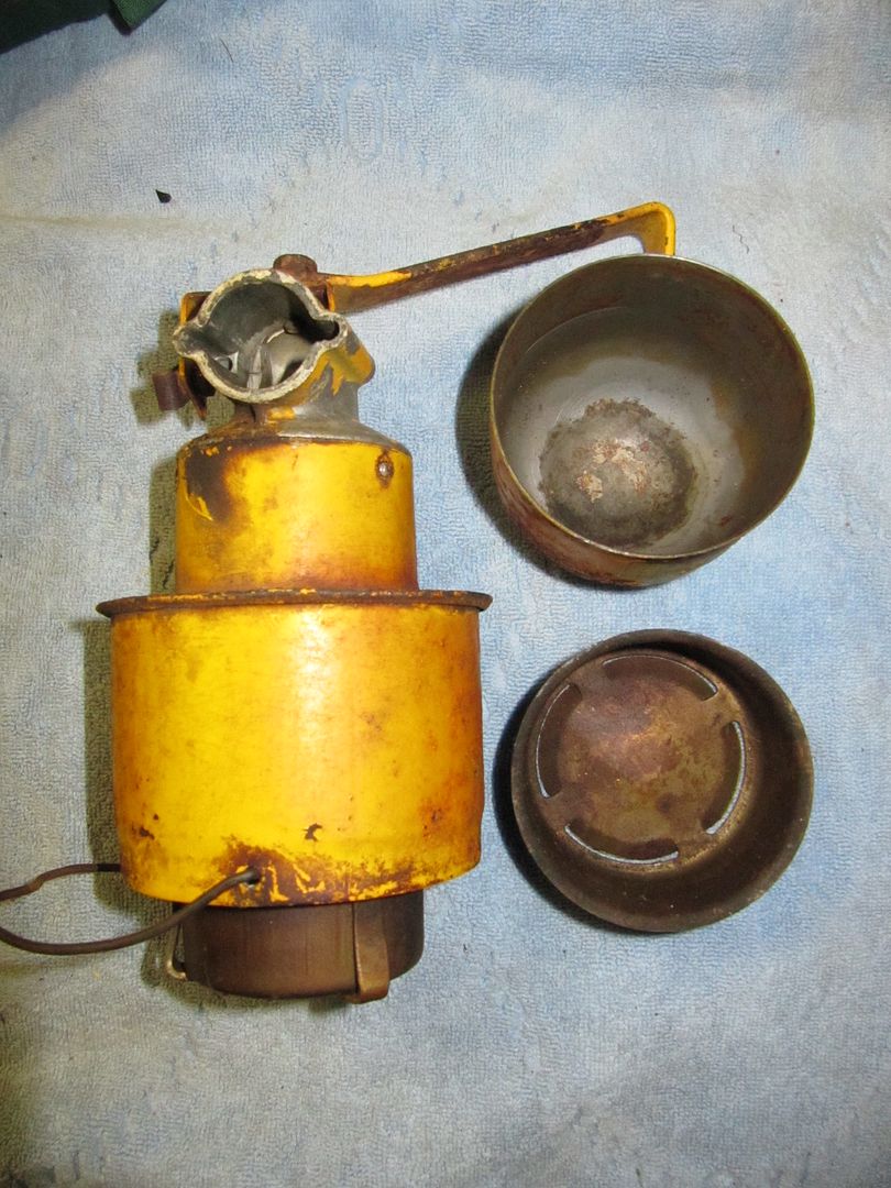

If your old cup isn't dented or rusted you should be able to remove the baffle. It comes up over the top of the cup where you should be able to separate it and slide it out, this also allows you to properly clean the dirt out of the bottom when you change the oil.
Here's a pic from another members thread, you can see the cup top right and the removed baffle below it. Hope this helps.

Nope, it has a raised line about an 1 1/2" long stamped into the cup and baffle, that is the oil level.
Originally Posted by nick4030 View Post
Anyone know about removing the mesh? Thanks for the help guys
The mesh comes out the top, remove the three screws that hold the housing to the aluminum elbow, remove the elbow and you can slide the mesh out the top.
