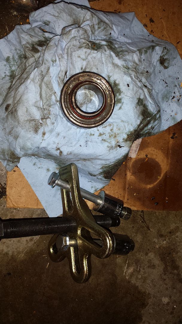

I sometimes wind up putting a 3 jaw puller on to get them off .

If you have a flywheel puller you can try something like this. Not as good as a 3 jaw puller just takes a few tries.
- Tim
