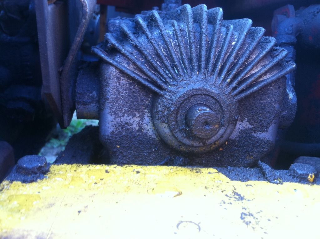

After doing some trailer work with the cub the other day, I decided to give it a spring washing. With just a little tap of a scrub brush, I pop off one of the fins on the fan. It's not old and brittle, its not even 1 yr old!!! So then I thought, well maybe I'll find an aluminum one and make a hub for it. It turns out not too many manufacturers made hydros with aluminum ones...(maybe a finger/liability issue i assume?) Anyways, I'm at the boneyard today and saw the rearend from a 316..it has a steel fan on a stub shaft working off the back of the charge pump, which is the same pump as the cubs....has anyone put one of these on a cub?? I'm trying to think if it will clear all things, seat pan, rearend, etc....but was just wondering if anyone has, as it seemed like maybe a much better piece than brittle a#% plastic!!

thanks gentleman.. i shouldve taken a picture.. since the fan works off the back of the charge pump, i assume it must be as a "puller" fan.. which actually makes more sense to me just because theres more cooling fins on the back of the pump and its out of the way... the only thing im wondering about though is if the fender pan or battery box is going to be in the way?? i will dig into this some.. the roll pin on it was not going anywhere and i didnt really have the right size punch on me.. so it will have to be another day.. keep you posted

I have a JD317 and thought about doing the same thing but the Cubs do not have enough clearance for the fan behind the pump. The top of the trans sits higher and the battery sits down too low.

The 316 rear end case is a lot different, on the cub the case sits too close to the stub shaft to fit a fan on the rear. ( Sam beat me to it, lol)

thats why this place is the greatest!!! thanks gents...actually i was looking through some old resto photos and i saw that too...bummer....well, maybe now i try to fabricate one out of aluminum...the old monkey wards i got is in need of one also, and it has an aluminum one...looks like someone took a hammer to it..it just bothered me on the cub..i could see if its 40yrs old and pops off like that, but like i said, its not even a yr old!! im not too excited to just keep throwing 17 bucks at it for that crap either..of course, maybe i should just be more careful, but i dont like "delicate" sh$@ on tractors!!
