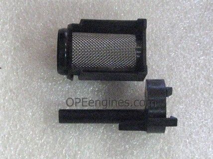

Im getting ready to start putting back together an m18 and the only part i simply cant find is 52 237 02-S number 48 in the attach parts diagram. Its a thin piece of spring steel and it holds the oil pickup in place. Any ideas on how to work around this? Do any of you have that part laying around?

The parts diagram calls it a clamp. When the oil tube and the box with the screen is installed in the block, that little piece of steel is flexed and jammed in there to put pressure down on the screen/box to hold it in place. When I opened the engine up, it was snapped and the screen/box was loose from the tube.

I just reassembled a M18. All that part is, is a piece of spring steel. It's about 1" X 3" long. It is wedged into place just above the oil pick up screen and holds it in place. See photo.
Try a hardware store to see if they have spring steel. You might try a piece of steel banding material if it's springy enough. Also there are many people on ebay who have parted out M18's. You might contact these people to see if they have the part.
In the attached photo, you can barely see the part to the upper right of the pickup. This shows you how it is placed in the engine. I know it's not the most informative photo, but make sure you pin the governor shaft in place or you may end up with the mess I had to deal with in the photo.

Maybe the newer oil pick-up tube kit does away with that part. 82 755 29-S Replaces 52 095 03.
