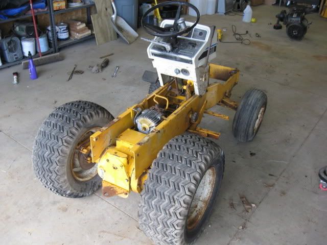

The tire on the right is on the correct rim (8.5" wide). The tire on the left is on a narrow (6.50") rim. They are both 10.50 tires.

These are 10.5s on 7" wheels meant for 8.5 tires. They cleared the fenders fine.
