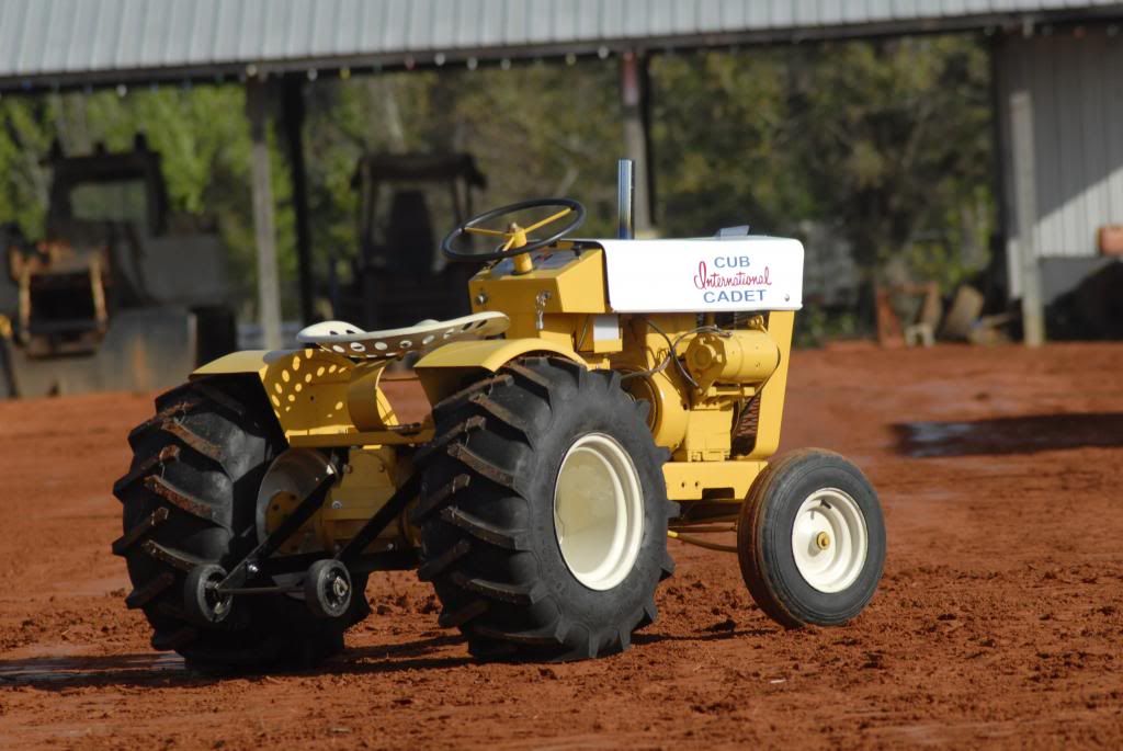

I've got a 10-horse in one of mine and it has the original-sized pulley on it. It's actually our pulling tractor. I'll include a picture of it. Interestingly, the belt doesn't slip on it, even when pulling. It has enough grip to stall our 10-horse with the nose in the air!
An original with a creeper and lights, that's pretty cool! Here's ours.
That's a sharp looking machine! Could you post up some pix of the other side (not to hijack the thread) but that stack looks perfect lol
