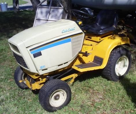

New to the club - just bought a Cub 1641 with Cat 0 3-point hydraulic, 501 hours, all original books and manuals, and even the sales invoice from when it was purchased new.
My problem....
The tractor starts and runs so smooth and quiet it is a dream to listen to and drive. All the hydro works great.
However... Here's the BUT...
Idling it doesn't appear to smoke, full throttle, it smokes some.
When I engage pto, the mower (48" deck) turns a little, doesn't appear to ever reach full speed, but pulls the engine down and will kill the motor in probably less than a minute.
It acts as though the engine does not have enough power to pull the mower. Yet... Driving, operating the lift, nothing else even phases the engine.
I remove the drive belt and engage the pto and it turns just fine.
I can turn all the mower spindles and idler pulleys with my hand, so they appear to be okay...
What is causing this?
Do I need an overhaul, since it does smoke a little?
I suppose my thoughts are that even if the motor needs an overhaul - it should still at least have the power to pull the mower deck while sitting still in the driveway. Especially since it runs and sounds so good, that is - except for a little smoke.
Any thoughts - suggestions?
Thanks in advance...
