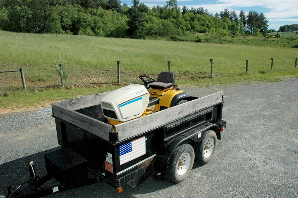

How many of you have built your own trailers? I have built my past two trailers and would only buy one factory if I needed a dump trailer.
Mine is a heavily modified Shasta camper frame. The frame has been beefed up, and I made the fenders, side rails and tail gate for it. It's been a good trailer so far.
What's yours look like?

Here is mine
