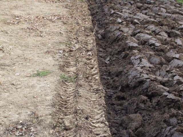

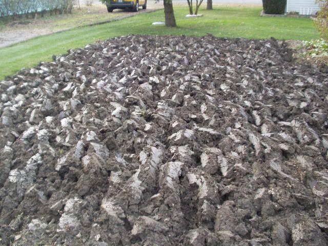

There are several factors when it comes to plowing. Soil conditions, what condition the plow is in, and how the tractor and plow are set, are some of major factors.
Hauling the mail or fast plowing most times isn't good plowing. It would be interresting to know if the 108 that ihnick talk about has a stock 10 horse power motor in it. In the past few years several have added weight to their plow. Most times slowing down a little will eliminate the need for extra weight.
This is good plowing as far as I'm concerned.
The furrow wall is clean and the bottom of the furrow is flat and smooth...unlike the ones who plow faster speeds.
