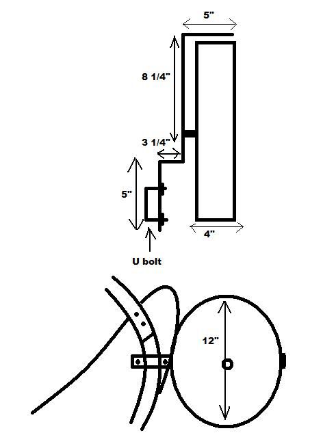

I know what your talking about, I'm pretty sure it was on eBay but I can't find it on there Heres a little drawing I made of the STOCK setup on mine, not sure if it will be of help to you or not.
That drawing looks like it may be the one that looks factory but the measurements are very helpful, thank you.
I was positive I seen it on the xtrememotorworks.com website but I don't see it there now. I liked it because the had an adjustment on it where you could raise or lower to control your depth.
Yes, I got the measurements off my cat. 0 plow. You can adjust it simply by loosening the U bolt and sliding it up or down on the standard.

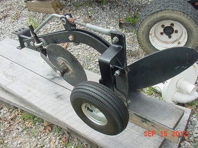

Here's a couple pics of the gauge wheel that was on Ebay.

I bought the guage wheel kit from the gentleman on ebay & it works great. Makes plowing easy by setting depth. Here is the wheel kit on my brinly plow.

I bought a complete guage wheel kit off ebay. The guy makes them and kit includes tire and wheel. It is all bot on and go. It works great, just set depth & plow no adjusting depth every time. The whole kit cost $55. Here is mine
