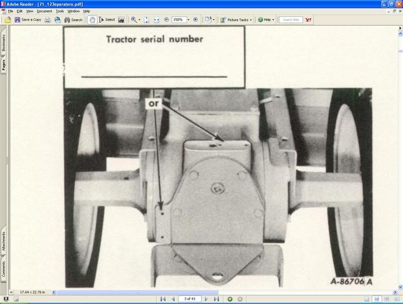

I found this in the manual. Mine doesn't have a plate in the lower location. Hopefully there is one in the other (top of tranny) location. I haven't pulled the sheet metal yet so I don't know.

they stanped the transmision with the serial # to might have to scrape some crud off of it the serial #on the transmision is under the fender next to the tire good luck in finding it

This thread may be old but it just saved me so much frustration. I looked everywhere, or so I thought, for the serial number on my 122. I even cleaned the trans with lacquer thinner but nothing to be found. I took the seat and rear sheet metal loose and sure enough there it was on top of the rearend housing. 142413 by the way.
