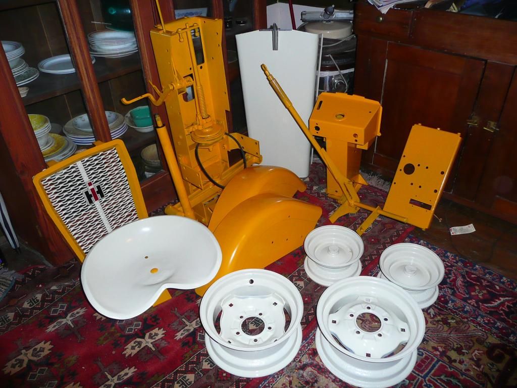

I seem to remember reading somewhere here about installing the decal on a O and some said to do it differently than using water. I am getting ready to install one and just wondered if using the tried and true of using water to enable to slide the decal around is still the preferred method.
Been a real joy working on it and now I am putting all the pieces back together and just want to know of any problems I need to look out for.
I have the tires mounted and will soon have it on it's feet. I have to move it to my back porch before it gets to large and heavy to get through the doors and out of my kitchen. The electrical work will be next and the engine last.

Can I assume that you are unmarried? Lol you have a Cub in your kitchen how cool is that?
I will attempt to address my procrastination problem while you wait.

Been too cold to have pets outside! Makes sense to me. Someplace warm and comfortable to resemble it. All the dirt, grime and painting/sanding/bodywork/dirty repairs are already done. And I get my yellow fever fix all day long. The engine will take place of honor on the kitchen table.

I'm like you, not afraid to have parts in the warm house, lol! To me, they are not much more than a plastic abs model, granted all the dirty stuff is done outside!
