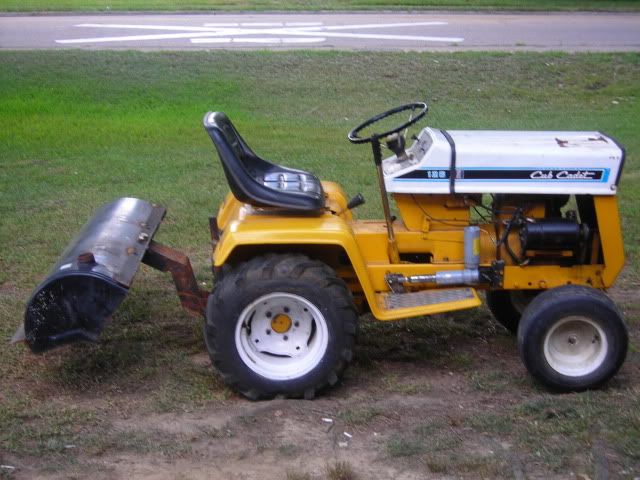

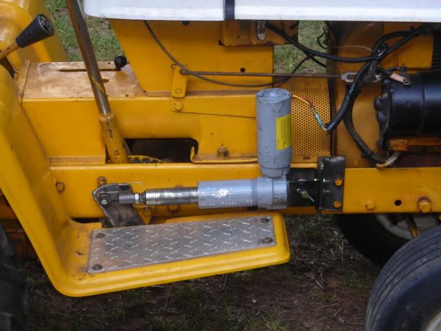

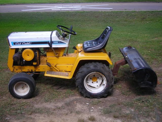

Got the balance gears out and engine back together. The second "free" engine works great. Had to change out pto bearing and basket pulley. My son helped me put everything back together. We fabricated an electric lift from a used linear actuator. I got the actuator out of the trash. It was from a school bus recall. It operated the electric doors on the newer buses. It operates the box blade fine. Here are a few pics.
How about posting all the numbers you can find off of that actuator? Brand, numbers the works! Please?
