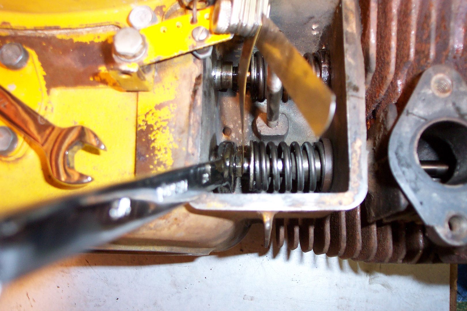

I'll describe how I do it on my 125 with a K-301. I had the engine out when I did mine but it can be done just as easily in the tractor. ( I rebuilt the engine)
Valve clearance adjustment. You remove the breather off the side of the engine. You rotate the crankshaft until the valve is fully closed. Using the correct size feeler gauge, slide it in between the valve and camshaft tappet. If it's out of spec, using two open end wrenches ( one on the adjusting nut on the tappet and the other on the tappet itself ) , turn it a slight amount and re check.
(click for big pic )
