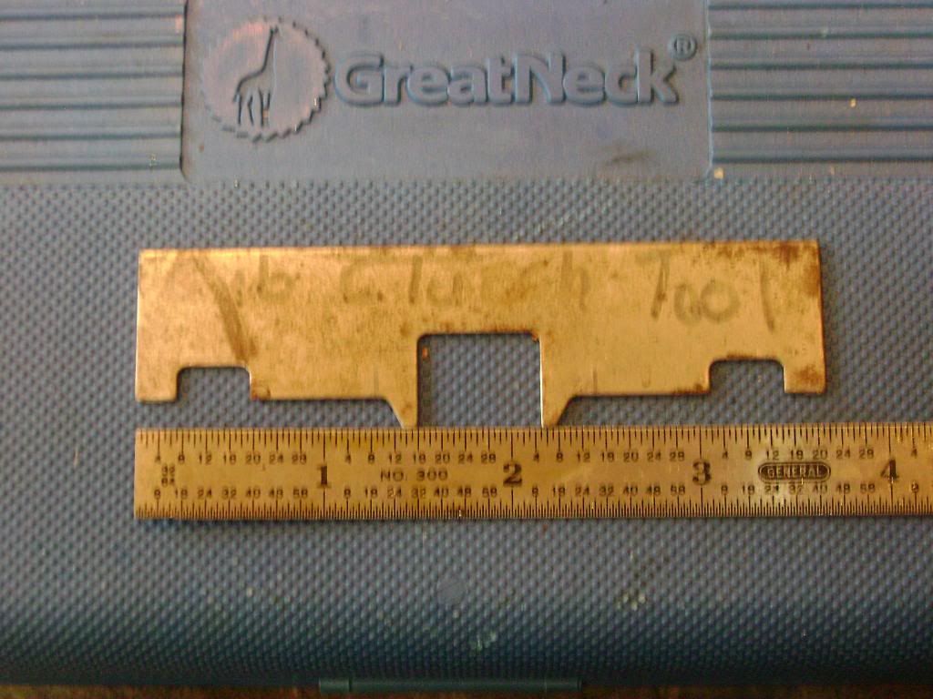

I realized the other day when I rebuilt my 128 PTO, that I had forgotten it took a special cut tool to adjust it correctly to OEM specs. It just so happened that I found the one I got years ago to adjust WF PTO's. I am just curious where any of you out there, get your adjustment tools for WF and NF PTO's? I am going to need one for a NF in the near future. If anyone had access to a water jet or some other similar piece of equipment, I have mine that you could use as a template.

the one you have pictured is for a NF.

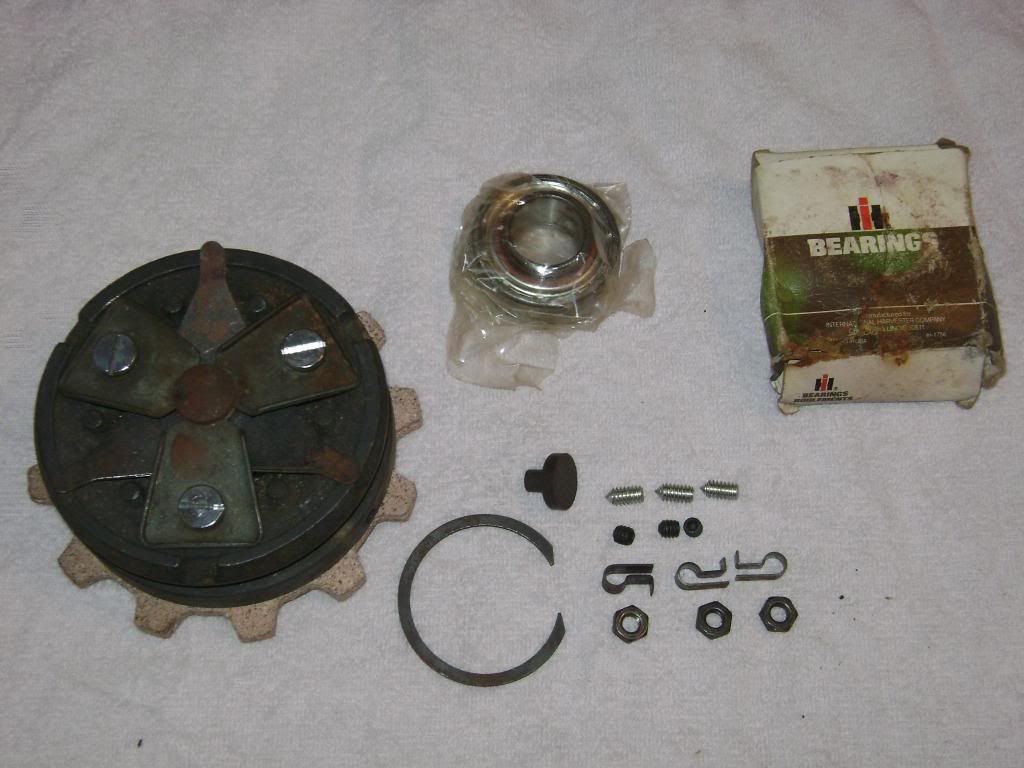

My pto rebuild kit came with one. I actually got one with more than just the clutch disk, it came with the bolts, jam nuts, and springs. I would like to see a kit available that comes with bearing and locking collar and all the set screws too. i know I would buy one just to have around

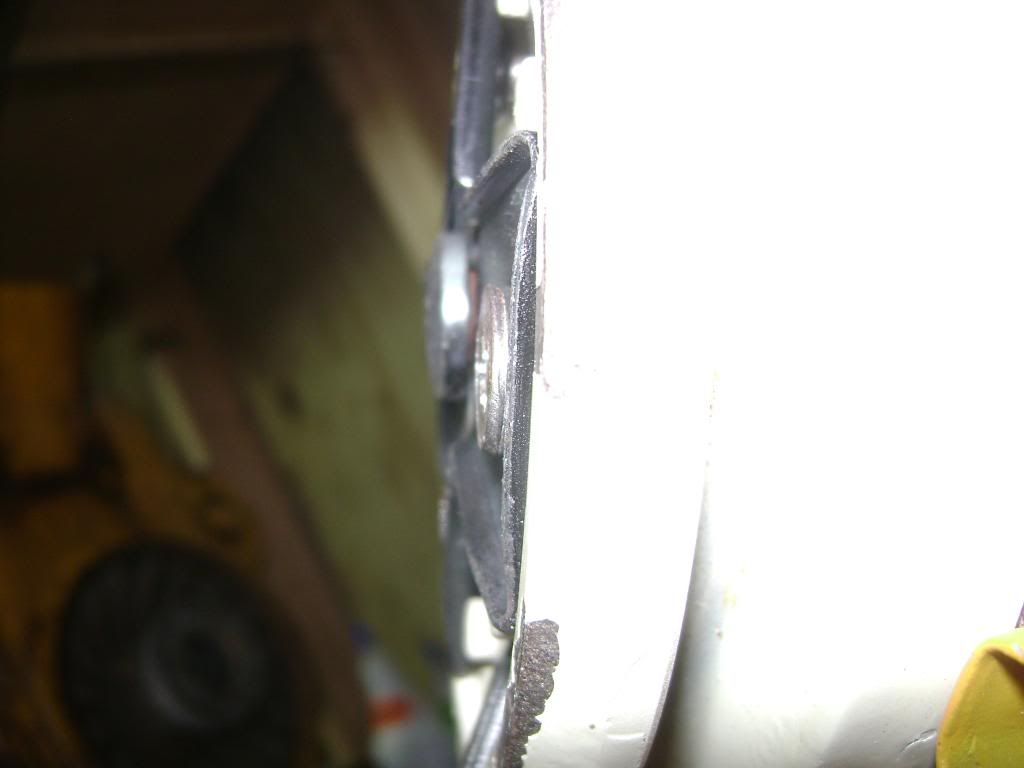

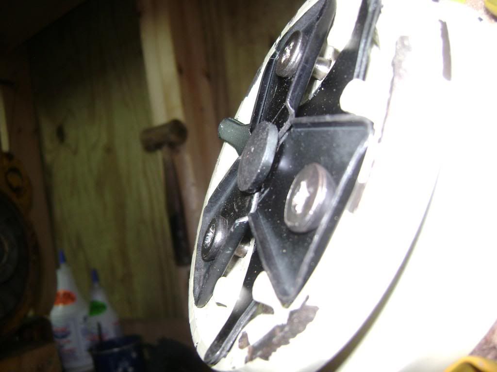

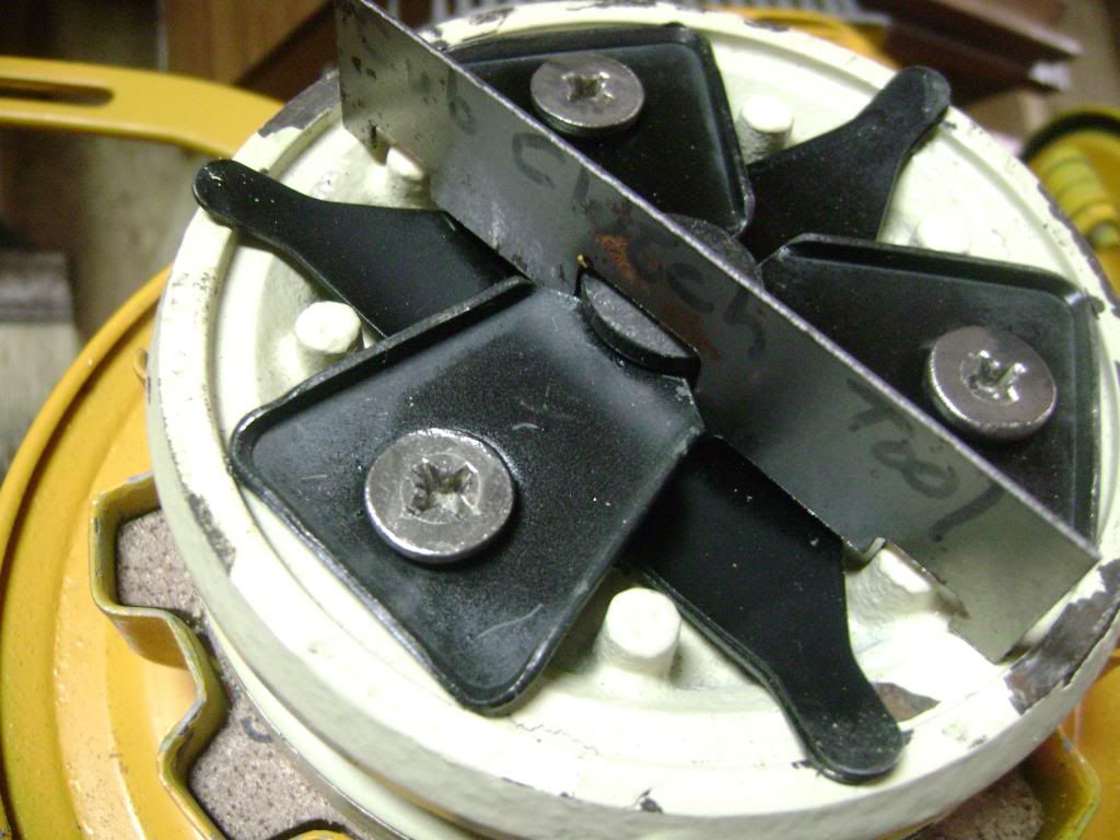

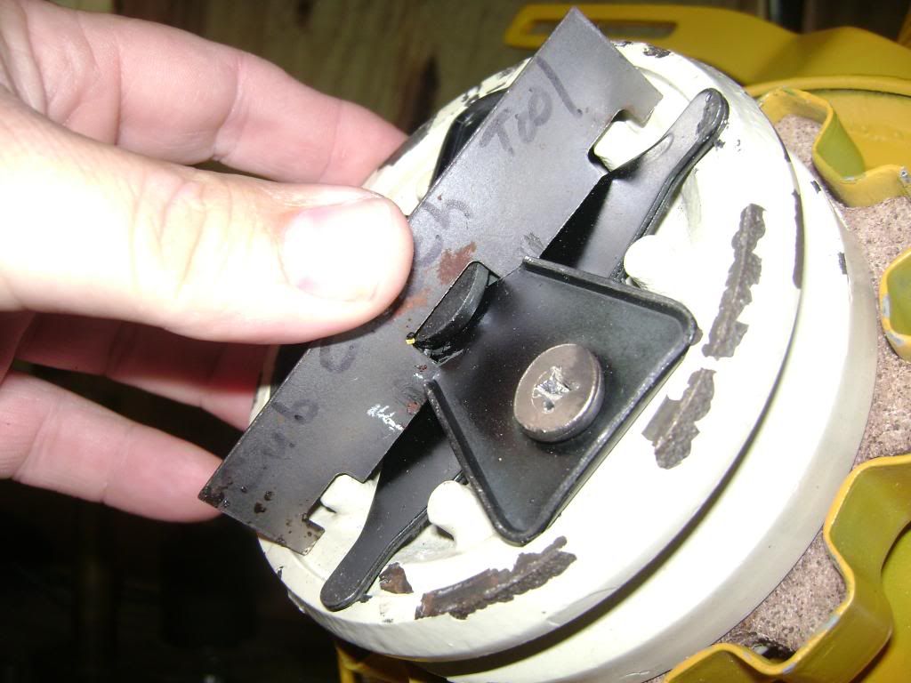

Some pics of the tool and PTO. All the ends touch precisely from the outer PTO edge to the center of the flat springs.
The three fingers are slightly above plane.

Posts: 11,221
Using the wrong gauge results in too tight a spring setting, the correct one is 3/32 less in height.
