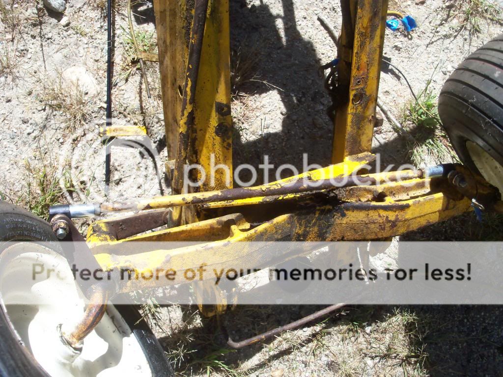

as for the cubs, my 72 is still slogging along as a faithful footsoldier as I have my 125 almost completely dismantled. It started out like this:

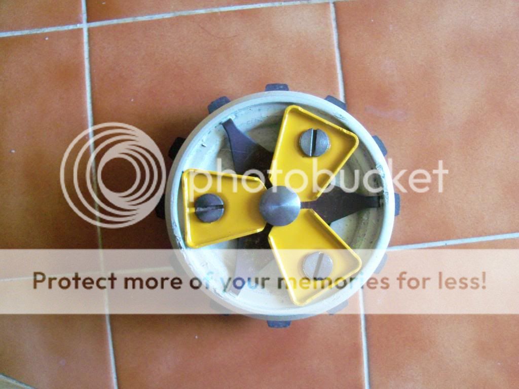

My PTO was in terrible shape
so i rebuilt it and bought a few new parts.

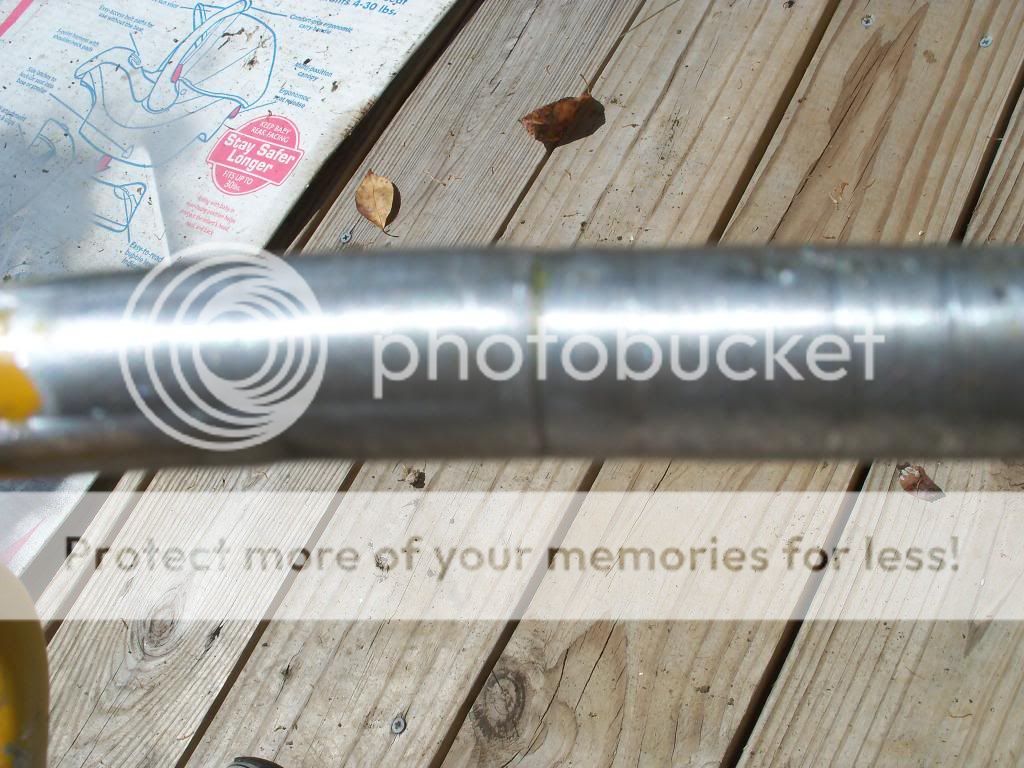

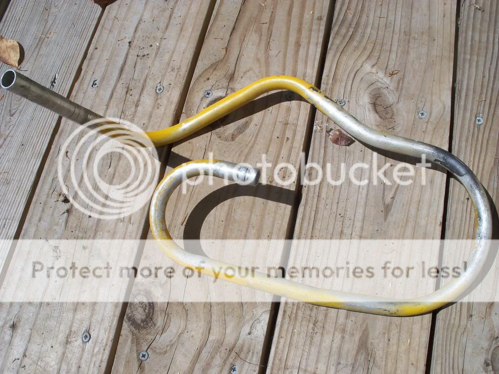

next, my suction tube had started leaking, and after removing it and a close inspection, it had a hairline crack where the crush fitting sat on the bottom feed. that explains why the leak got worse when I tightened it.
in this one, it's hard to see but there's a thin line of hytran that's seeped through the crack.

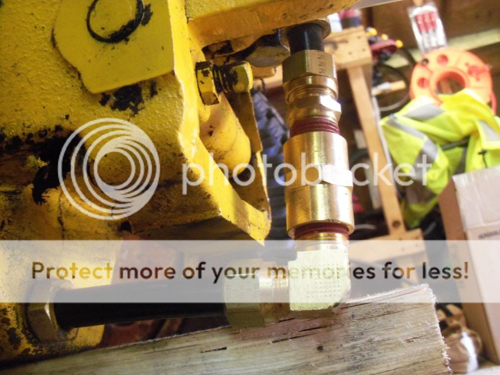

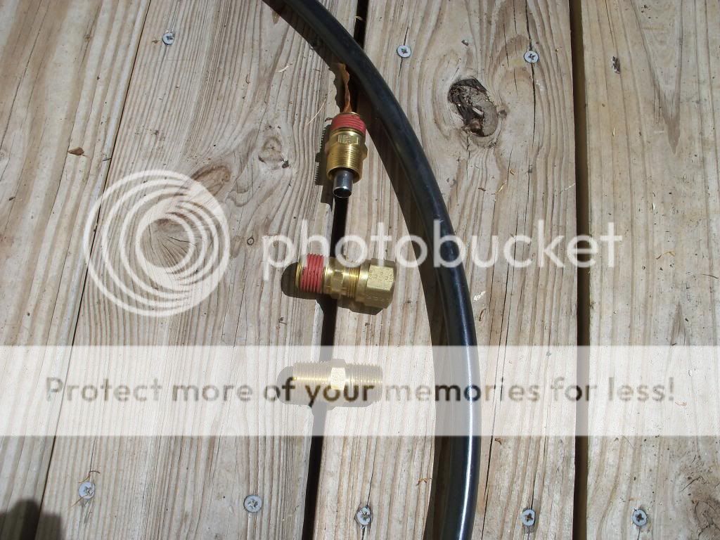

Anyways, rather than spend big bucks on the cub factory replacement (the original style is NLA), i fabricated my own with some heavy duty tubing and air-line plumbing used on Semi trucks and some fatherly tutelage.
the design changed a few times, but this was the end result.

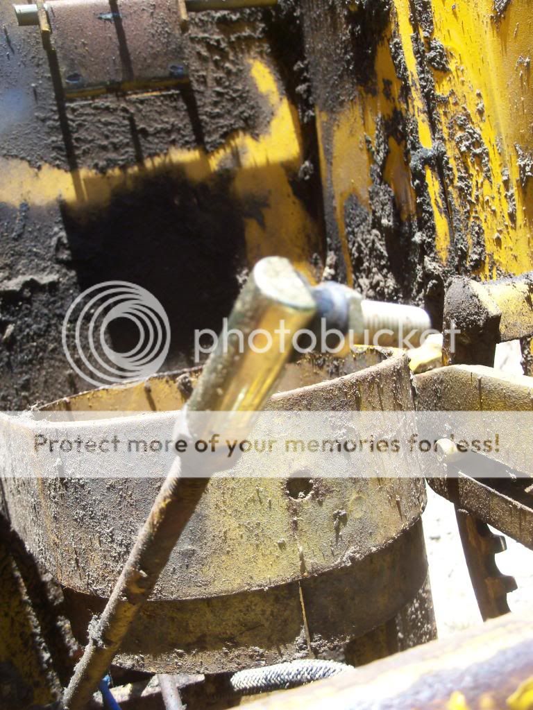

next, while the tractor was split, I noticed the drive pin on the drive shaft was pretty much shot.
So that got replaced with the correct part.

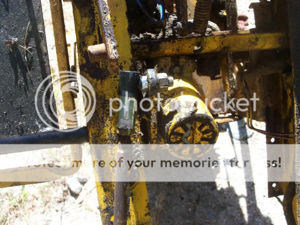

I also replaced all the steering ball joints and snugged up the steering box.
I also replaced the trunnion springs (sorry no pics yet), but I had noticed there was a lot of play in the shift linkage ball joint so i replaced that one too. I wanted to do the one up front but it seemed tight so I left it.

Air line tube is not designed for: heat, or oil. I have seen air line melt where it was simply laying on a hydraulic line. It also is not designed for continued contact with oil. Not trying to be critical, but I'm afraid after getting the tractor running, your going to end up with a very large leak!
Old 09-28-2013, 11:32 AM
cadzag72 cadzag72 is offline
Posts: 670
Thanks for the concern, but fear not, this hose is rated for low pressure hydraulic use, and is good up to 250 degrees. i figure if I make my rear end that hot, i have bigger issues. and I figure being a suction tube is a fairly low pressure situation, and I did install fittings to prevent it from collapsing. time will tell, though!
