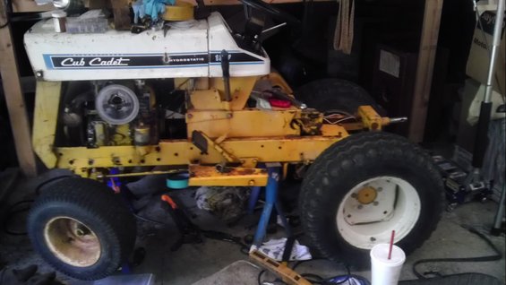

I had a thread started on here but it is gone. Not sure what happened, but I was going to attach pictures and my computer crashed...So, if you are a purist, you may not want to see this.
Here is what the wiring harness looked like when I got hit home.
This is what it looked like when I figured out what was going on with it.
It is in the process of getting the loose linkage in the hydro fixed. I think its a 71 so its older than I am and I want it to run another 40ish years.
SWS

No questions, just showing what I have. Now the rear end is behind the tractor and the linkage is off and in my toolbox where I am going to "fix it" by welding and adding new springs.
I built a new harness for it already. It is back in and running. I want to fix the hydro before getting the Bosch coil and points saver. I eventually want to have efi and a turbo on it as it will be working year round from grass to snow.

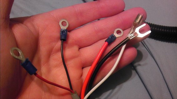

I am still having computer problems so you will have to bare with me on this. This is what I built to fix the wiring harness problems.
I think it was just a bit more than heat shrink could handle.

Old 05-31-2013, 12:28 PM
red56turbo's Avatar
Posts: 2,523
Nice job on the harness! That series of cub is notorious for wire harness failures.

Old 05-31-2013, 01:18 PM

Old 05-31-2013, 06:21 PM
Location: Fort Wayne, Indiana
Posts: 728
Build a Megasquirt for it!!! That would be the sweetest thing EVER!
Also... Nice work on the harness, but if you get the chance again pull those BS plastic tidbits off of the connectors, crimp them, flow solder into them, and shrink tube them back about 1"... That connection, short of mice or fire, will never fail again! If you really want to go for broke, flow liquid electrical tape over those connections at their outlets (switches, lights, whatever) and add weatherpak connectors up stream. I'm slowing doing that to the 1650 to make her wiring totally waterproof.
Good luck with it!
