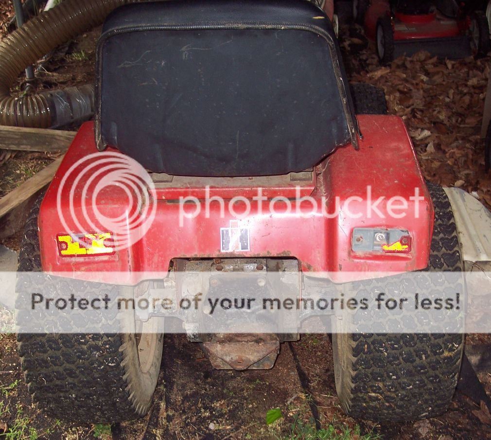

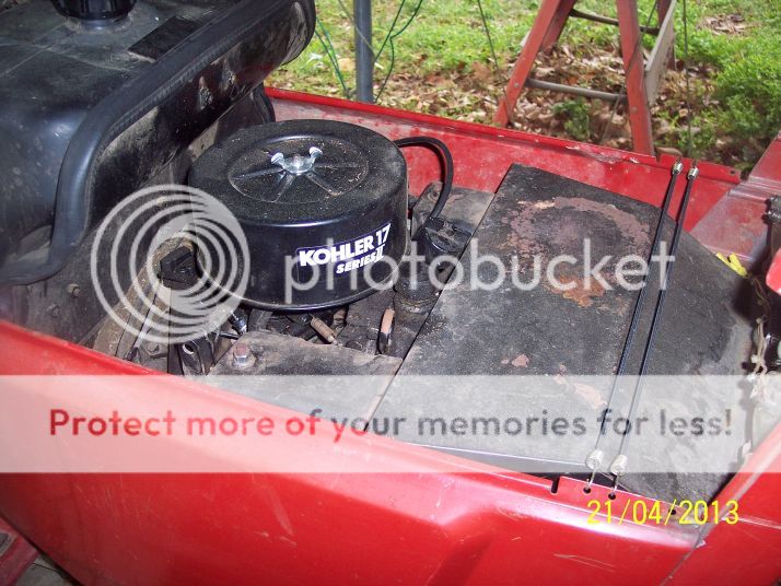

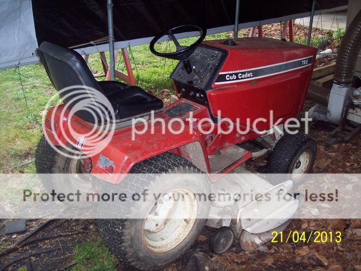

Default Details of my 782
Thanks for all the encouragement on figuring out a rear hitch. Here's my tractor:
Model 144782399
Serial 20506010733219
It has the series 2 engine (good)
It has an aluminum rear axle (not so good)
It runs great and I cut my yard with brand new blades yesterday -- I actually ENJOYED mowing the lawn. All in all it seems to be a great machine and a lot of fun to use.

Old 04-21-2013, 08:58 AM
Nice 782, you'll love it!
Old 04-21-2013, 09:10 AM
Posts: 18,859
Model 144782399
EDIT: Would this hitch fit: http://onlycubcadets.net/forum/showthread.php?t=24026
Thanks again,
Mike
Mike
As far as I know most of that hitch will work but the part in the yellow box is for a cast iron rear and you have the aluminum rear. Xtreme has a cool bottom hitch that you may want to look at.
