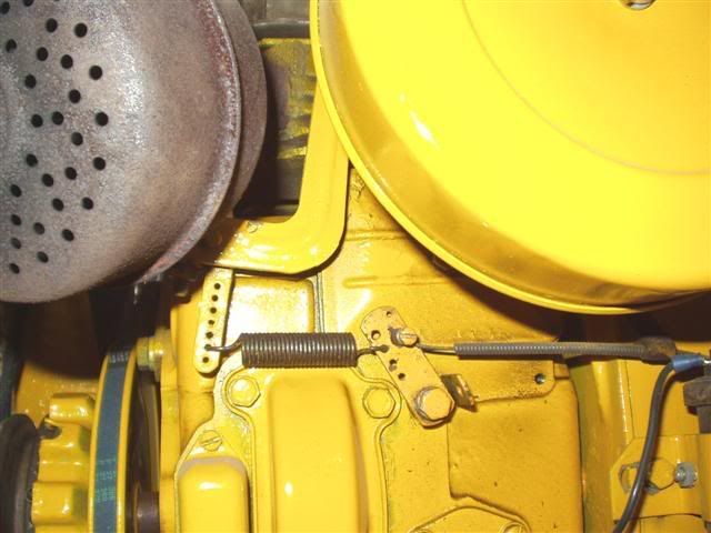

Does your 122 have this throttle stop on it(L shape bracket)?
Is it set?
I would check that first. If the stop is not set right the motor will run some big RPMs before it lets loose.

do you mean this piece if so how do you set it correctly?

Loosen the bolt below the throttle cable and spring. It will allow the L-bracket-throttle stop to move. I would move the throttle stop counter clockwise a little and tighten the bolt. Move your throttle to wide open position. The piece that the throttle cable connects to should be against the throttle stop. Start you Cub up and run the motor wide open making sure the motor isn't running to fast( I do this by ear). Using a tach, check the motor's RPMs. Kohler spec for maxium RPM is 3600.
You may need to move throttle stop if the RPM is too high or low. Repeat the above process if it needs moved
