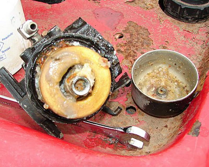

Neighbor and I invested in an ultrasonic cleaner from harbor freight. The results were pretty impressive. Some stubborn issues remaining after a "bucket soak" with carb cleaner were resolved with the ultrasonic. Some of the residue that came from the carbs would simply not dissolve in carb cleaner. Loose metal oxide particles or rubber bits from dissolved rubber fuel lines did get vibrated loose. If they would have been removed by a shot of compressed air - who knows?
A bucket soak didn't help this puppy - if the carb cleaner solvent can't physically reach the blockage, it can't possibly have a chance to dissolve it. Different approaches may be required to resolve varying degrees of carb issues.
The carb cleaner dissolved the vaseline-like buildup but did not touch the salt-like grains in the bowl or main tube.

sorry bro but your wrong there. your just throwing the dice, and hoping the 6 tiny holes in the tube come clean.
40+ carbs and 100% success, even with some really nasty ones nearly as bad as save_old_iron's picture, and I'm wrong?...oh, please. How many carbs have you soaked in carb cleaner that didn't work correctly afterwards because those holes were still plugged?
Regardless of whether or not the bucket soak works, it'd be better to try that first instead of just removing the jet first, which is fragile and easy to break. Not to mention it's also probably NLA or very expensive if it is still available new. Why take the risk if it's not needed?
