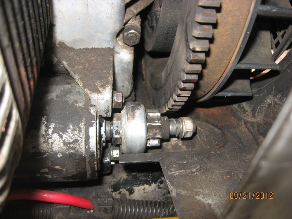

Default M18 Starter on 1811
This afternoon I pulled off the engine cowl on the left side to clean and lube the starter drive on my 1811. I was really surprised at how easy it is to access the starter. Far easier than I had anticipated. Photo was taken before I cleaned the drive and put on dry lubricant.
I also installed an inline fuel filter where the fuel pump would be in the line. My engine was having problems after it was warmed up and that problem appears to have gone away now that the fuel pump is out of the picture. Gravity feed works just fine on this application. As long as you keep the fuel in the tank above the level of the carb it should work fine. I capped off the ports on the pump with plastic cap plugs.
