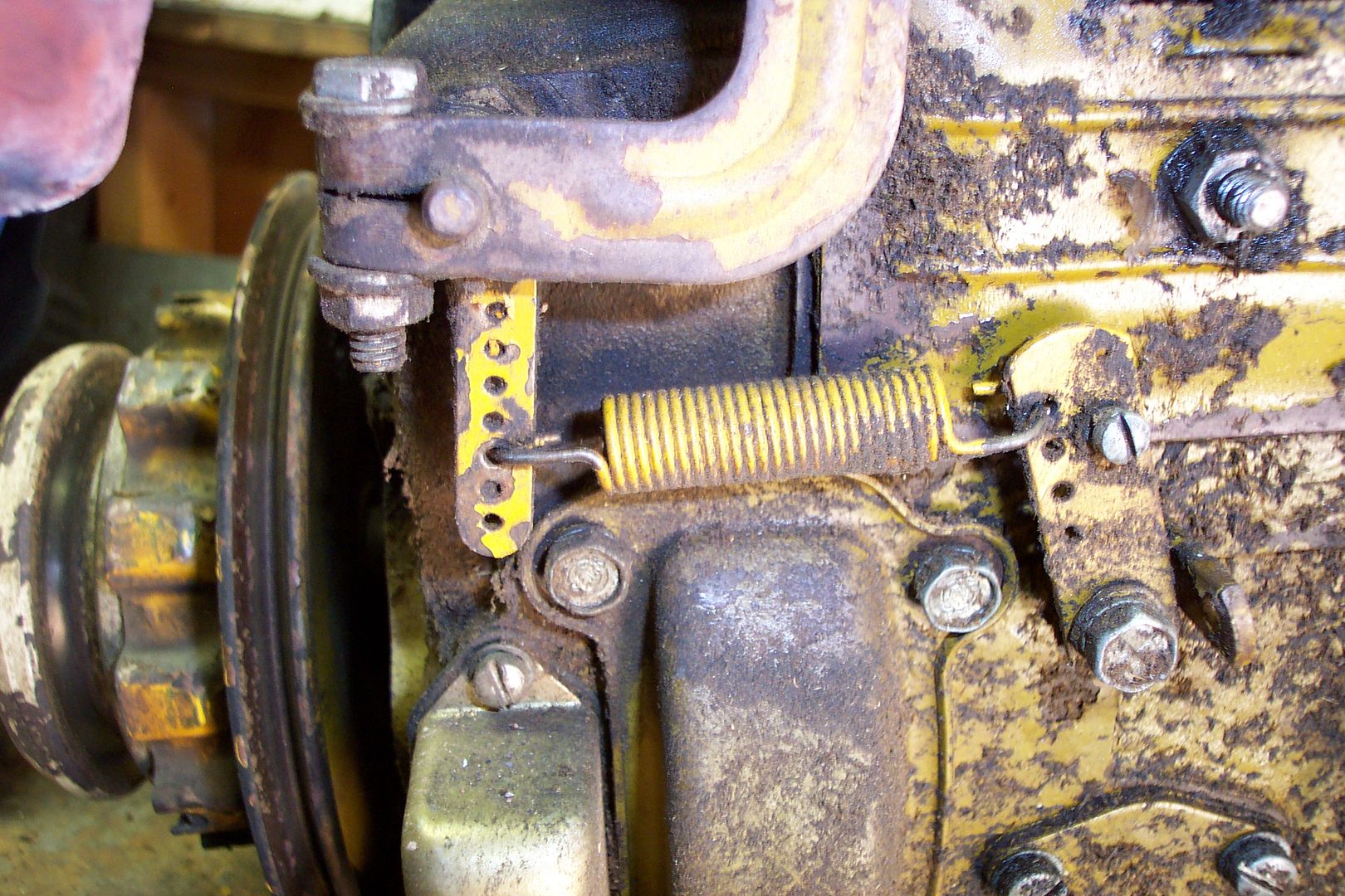

where the end that mounts in the governor arm moved it to a more sensitive hole
Old 04-29-2012, 07:12 PM
Here's where the governor spring is set on my 122
click for bigger pic
Might works perfectly in this position.
