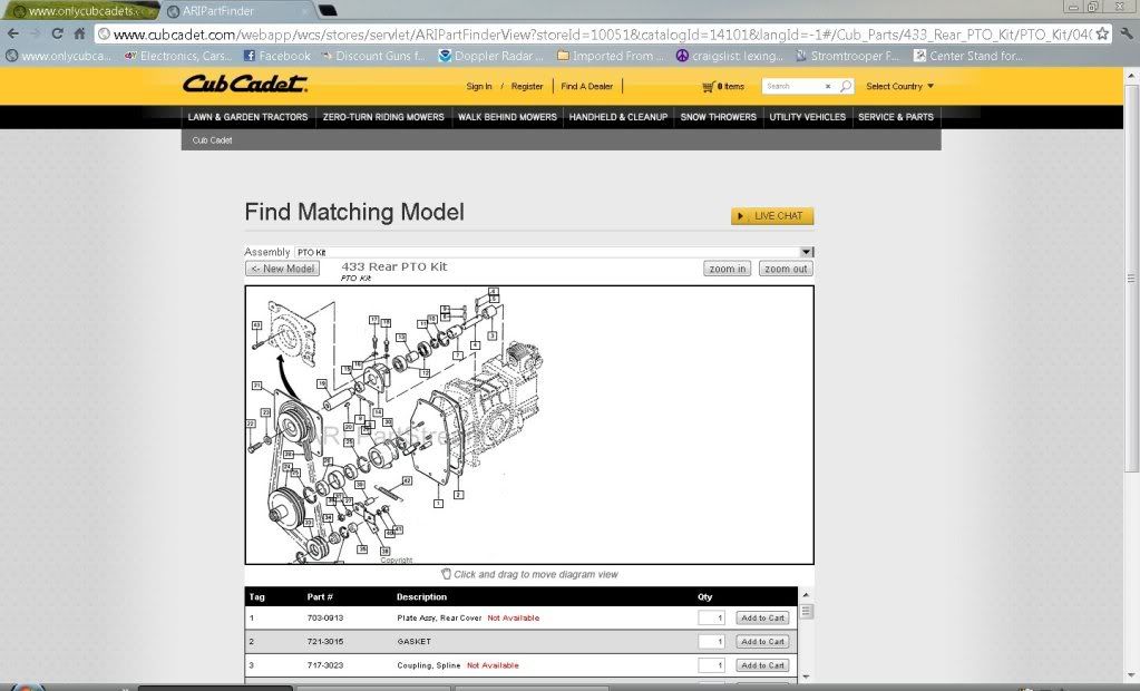

Old 04-16-2012, 05:17 PM
Even the 982 PTO's are ultimately belt driven:
