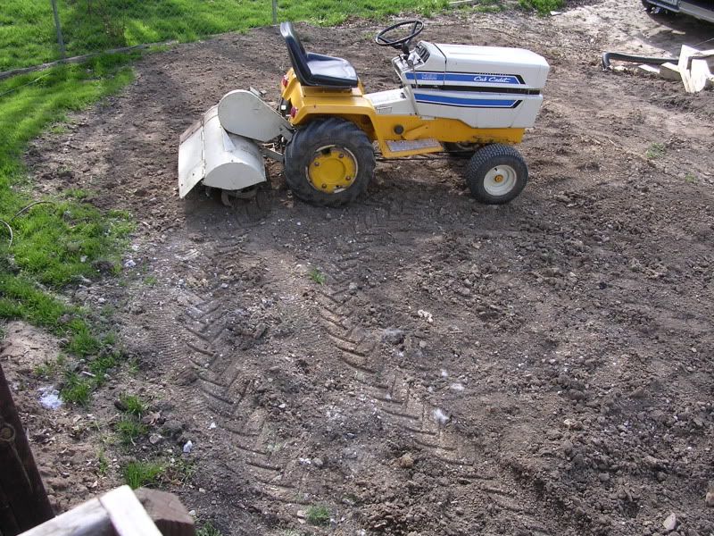

Here's the picture as promised. This picture was taken four years ago when the Cub was being used to till up my back yard for new sod...

Nice 1450 and tiller!
