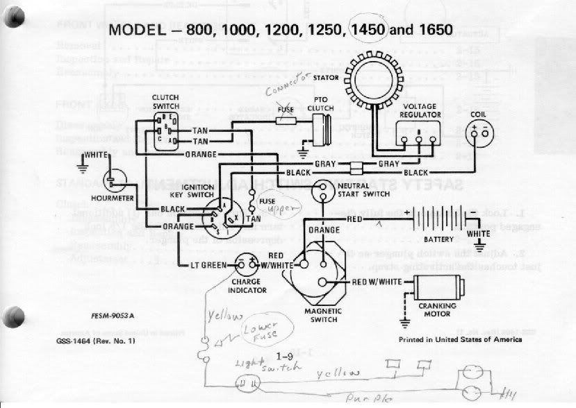

I had to do a repair from a previous owner who rig something up. While doing this, being in that cramp area I disconnected wire from pto switch. Now I tried to find it in the right spot here on this site, but my computer will not open the page. Not the sites faught, its my computer. Can anyone show pics for wiring for pto.
luke
Old 10-22-2011, 08:42 PM
Here you go

Thanks DWAYNE,
That did the trick. I was trying to plug wires in different places and once the tractor just took off. Thank goodnees it was just idling. I could see it now in the morning news, Man gets run over by cub.
I printed and followed your drawing of wires, made it real easy, thanks. For some reason my computer will not bring stuff up, says I need to down load something and I try to do it but it always stops and does not finnish.

Try downloading and running Firefox as your browser. It is what I use and I like it much much better than Internet Explorer.
That drawing came from the WF/QL service manual that is in our Technical library. If you get your computer to working you need to download and print it out. Very informative manual to have for your tractor.
