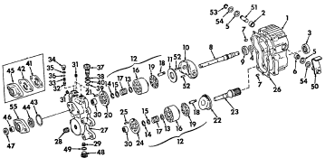

Hi Guys!! Well earlier today I after moving my 127 out of the barn I noticed a wet spot on the floor where it was. I checked the back end of the tractor and noticed the brake was all "wet" looking and shiny. Hmmmm not good I thought. I ran my hand along it and sure as crap it was oil or something. I ran my hand along the bottom of the axle from the caliper towards the rear end and what do ya know? Red Hytran fluid was on my fingers. I will admit that I NEVER have worked on a tractor before and have absolutely no clue WHAT THE HECK HAPPENED OR WHERE THE LEAK IS. I bought this baby to be my learnin tractor and that's what I am gonna do.
So there's the longwinded problem. I can use the help with ideas as to what happened and how to fix it?
Thanks guys and have a great night!!!! I will.

maybe an axel seal,or number 25 in the top picture,the cover plate.Ill let you know i am not farmiliar with an external brake system and what could leak down on it,from the pictures it doesnt look like the hydro sits near where the breaks would be,but maybe a trunion seal or the seal between the hydro and rear.
For some reason the pictures came out real small but i can get a bigger one if you want me to point out the seals.

Another thought,clean it up real good and run it a bit ,then see if you could spot the leak,re reading your post it almost sounds like,the seal between the hydro and rear # 26 in the top picture
BUT it could come from a few orafices!!LOL
Id clean it real good run it shut it off and investigate so you are SURE what seal or gasket to repace,cause there is a bunch!!!

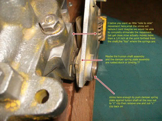

in this picture you can see the trunion shaft bottom arrow at an angel there is a seal in the case both sides here that can leak,(ingnore all the writeing,lol)
