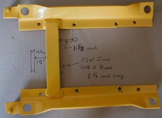

Merk 05-30-2009 04:57 PM
My Dad added an extra brace to the cradle on his 1450.
http://i152.photobucket.com/albums/s...b_Dude/3-1.jpg
http://i152.photobucket.com/albums/s...b_Dude/2-1.jpg
This tractor is used only to work ground (plow-till-cultivate).
