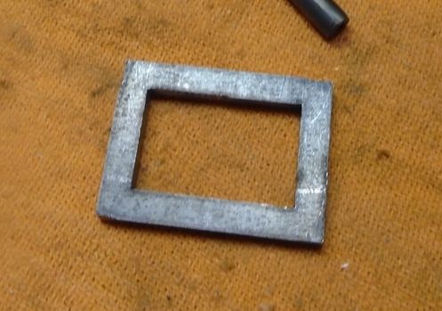

Yes, a worn cam plate , worn spring or spring retainers can cause uneven ( jerky ) movement.
You should have perfectly square corners for the best results.
http://img.photobucket.com/albums/v7...a.jpg~original

As Jeff mentioned, the corners need to be perfectly square. If you want the best results. When you were in it, what condition were the corners, and end cap, springs?
