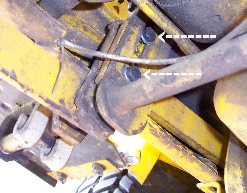

I have a cub 127 that I am trying to hook a sleeve hitch to. I am having trouble installing the lift arm pin plate to the deck lift arm. There seems to be some damage to the lift arm from the PO. I think that may be causing my problem. My sleeve hitch didn't come with any directions, so I'm not even sure I am trying to hook it up correctly. Does anyone have a picture of the pin plate bolted in place, so can see how to hook it up or see what i need to fix? Any help would be appreciated.

This picture is from my 125 ( hydro drive )
I assembled the lift bar to lift plate and slide it in from the back. Bolts are 5/16-18NC and take a 1/2" wrench.
When I put the rear lift in 122 ( gear drive ), I had to disassemble the ratchet mechanism to get the plate in, then slide the lift bar and use the "universal adjective" to get the cotter pin in the hole.
