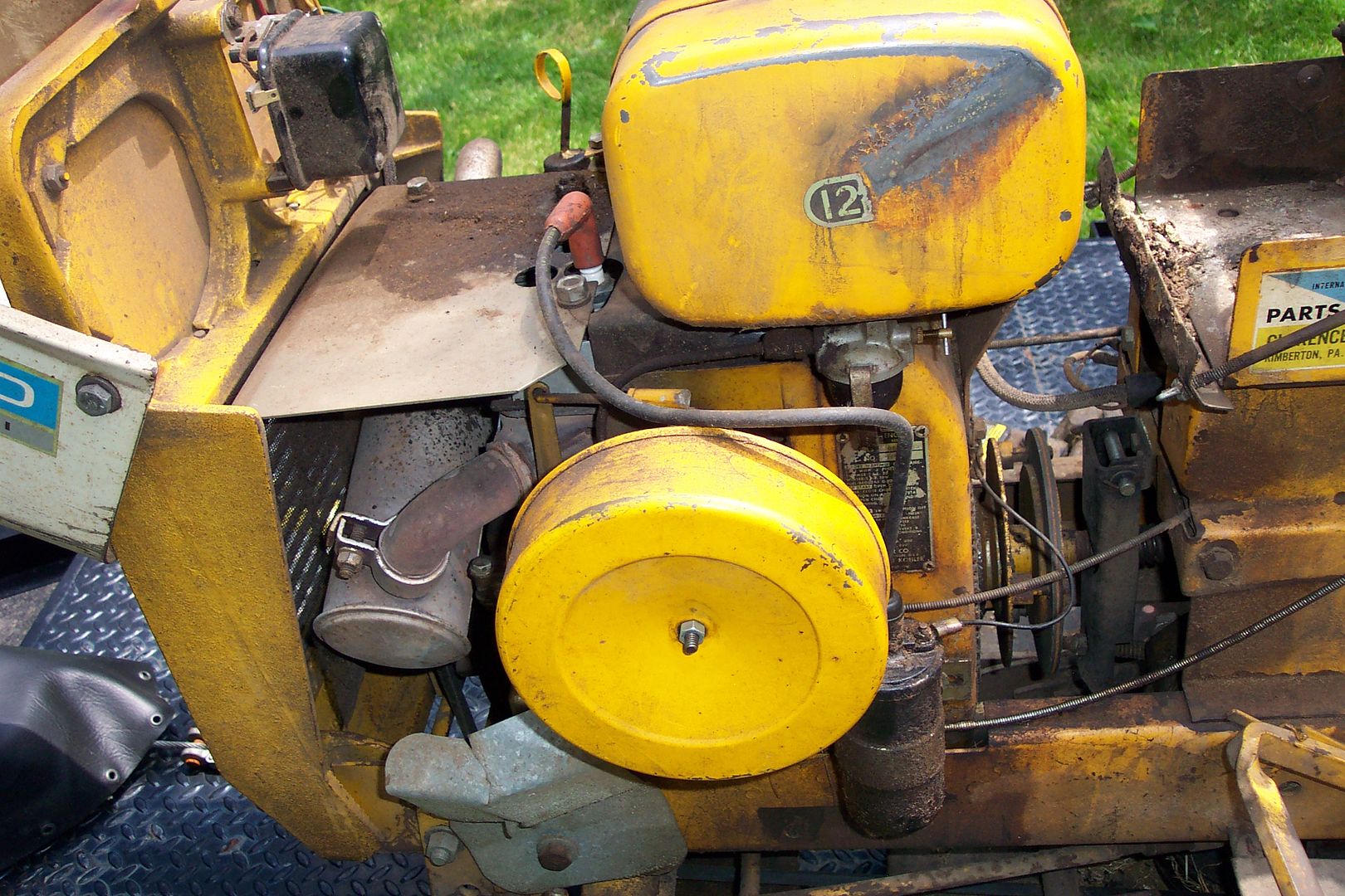

Hello there everyone, I'm new to the forum. I am having some issues installing the choke cable on my 122, not sure if it is the original cable or right length, it seems a little short or maybe I'm not routing it right. It was laying in a box with misc. parts when I got the tractor. I will post a better close up picture when I get home.

Ok, made it home and took some close up pictures, is this being routed the right way? Or is it the completely wrong size cable?
olds45512 04-16-2015 08:32 PM
routing looks the same as my 122, i bet the cables to short.

TigerCub 04-16-2015 09:33 PM
From what I see I'm going to assume that I have the wrong cable. I'll have to look up the part# and order the right one. Thanks for the help everyone and the great pictures.
darkminion_17 04-16-2015 09:55 PM
You have the cable mounted incorrectly. The choke cable bracket bolts on the flywheel shroud,and the throttle goes where you have the choke cable bracket .
TigerCub 04-17-2015 01:25 AM
In Sawdustdads picture the choke cable goes down and under the coil and up to the bracket and then to the choke. Is that not right? That's what I was trying to do, but the cable seems to be a couple inches too short.
J-Mech 04-17-2015 01:46 AM
Go to an auto parts store. Buy a choke cable. Cut it to the right length. They cost less than $15, maybe even less than $10. It will look just like the original one.
TigerCub 04-17-2015 10:57 PM
Think this worked out pretty good, went to Northern Tool and picked up a universal choke cable for around $10 and cut to length, did same thing with the throttle cable, that was about $8.
