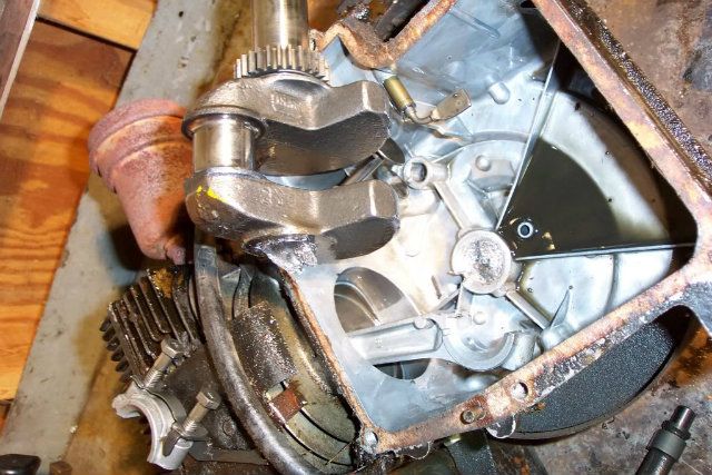

Here's the 8hp briggs out of my chipper. It stopped quite suddenly :bigeyes:
http://img.photobucket.com/albums/v7...5.jpg~original
http://img.photobucket.com/albums/v7...3.jpg~original

Ouch that's ugly. This is what I need.

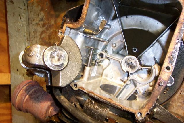

2 Attachment(s)
Here is the one I have, doesn't look quite the same but it may work. Yours if you want. The motor is scrap but I was saving it because it has the reduction gearbox on it.
It's worth a shot. I'll PM you my address.
