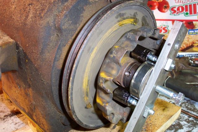

Gene the trick is to go back and forth with the stubborn ones, if you feel them start to tighten up then turn them back in and then turn out a little further. Each time going a little more. The bearing behind it has a locking collar that you have to turn CW to loosen as it is somewhat of an eccentric. Plenty of write ups on here with many tricks, tips, and oops now what's. Good luck and take your time. Breaking a set screw or stripping one adds a lot of time. I use a pitman arm puller to pull off Pto bearing
I use this

Parts box ( plus a guy has to eat :beerchug: )
Alvy 12-17-2014 05:52 PM
That's awesome Jeff. I spoke with Lew the other night about your basket pulley removal tool, did you ever add that one to the parts page? That bearing puller one is great, simple and effective. I just used a big posi lock puller to get a basket pulley off with some heat but it was tricky not to bend it, need to pull it from the middle hub area like yours

Jeff in Pa 12-17-2014 08:27 PM
Yes, the PTO pulley puller is on my parts page.
