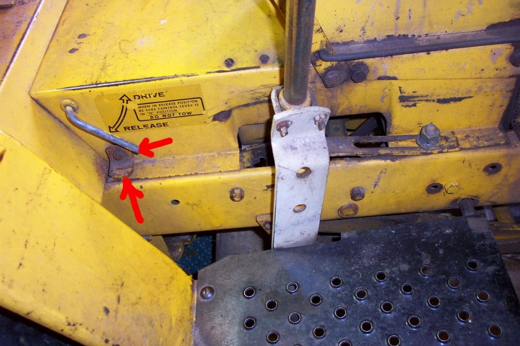

Jeff in Pa 11-24-2014 11:10 PM
Originally Posted by drglinski (Post 297081)
X2 to what J mech said. Best scenario for towing a hydro is don't. Second best is slow and hold the hydro dump for sure.
Move the lever back and hold it in place with the small flip angle hold down.
http://img.photobucket.com/albums/v7...2.jpg~original
TheSaturnV 11-25-2014 01:33 AM
And if that silver lever offers no resistance, the sheetmetal tangs inside are broken...like mine was. Meaning, the hydro will not release.
boyesreef 11-25-2014 09:48 AM
yup, broke here too. anyone got a plan or pictures on how they repaired theres? ive got a 1450
